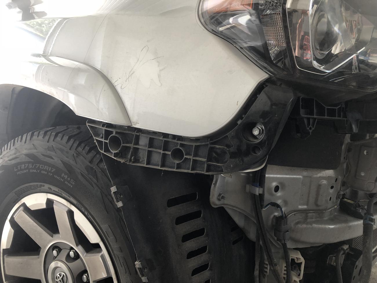

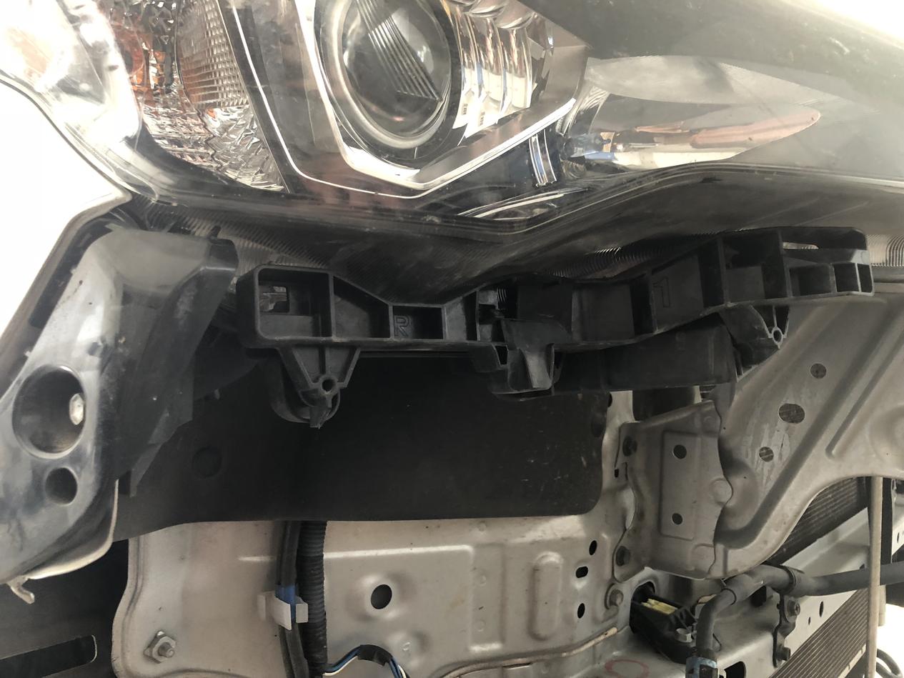

I'm in the garage installing my front bumper and have a couple of questions. I've got the bumper off and am removing the plastic parts. There are two plastic pieces around the headlights, one to the side and one underneath in the front. Do these need to be removed? See pictures below.

Yup- although I'm pretty sure that bolt in the hole on the last pic needs to go back in to hold the headlight housing in place. I can't remember off the top of my head but it'll be pretty apparent once you take it apart.
The bolt in the last pic definitely needs to be retained and reused. The question is after you install the bumper would you be able to remove a headlight without ripping off the bumper? I think with specialized tools you MAY be able to get that bolt out.
