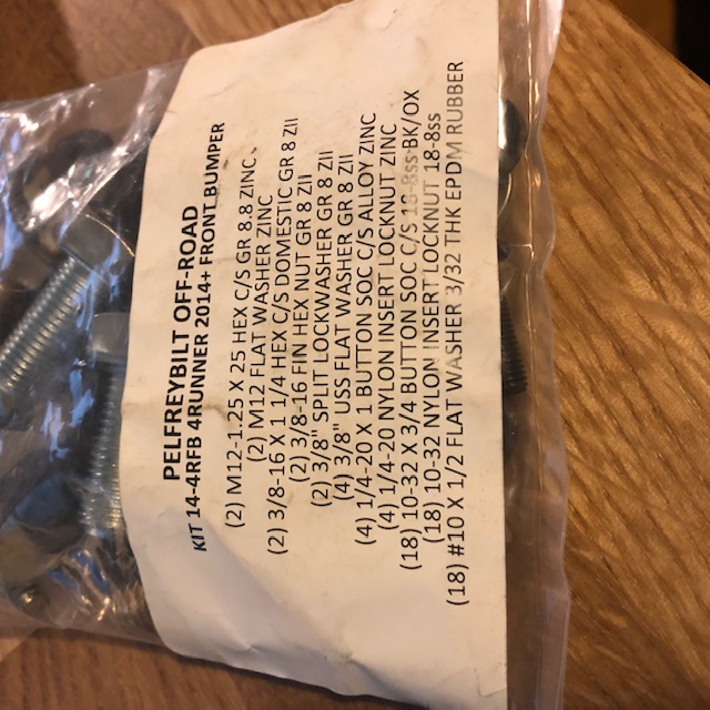

Would you happen to know what bolt size fit the side brackets (into the frame)?

The spot in the L bracket that connects to the frame is larger than an M10 bolt. I will post what size it is when I find out.
I have a hardware package I have yet to open. Slipped my mind. There are some larger bolts in there. I'll try to remember to check when I get home.
It is an M12 x 1.25 x 25
Not sure why the pic is sideways but there it is. Apologies for not looking at this sooner.
