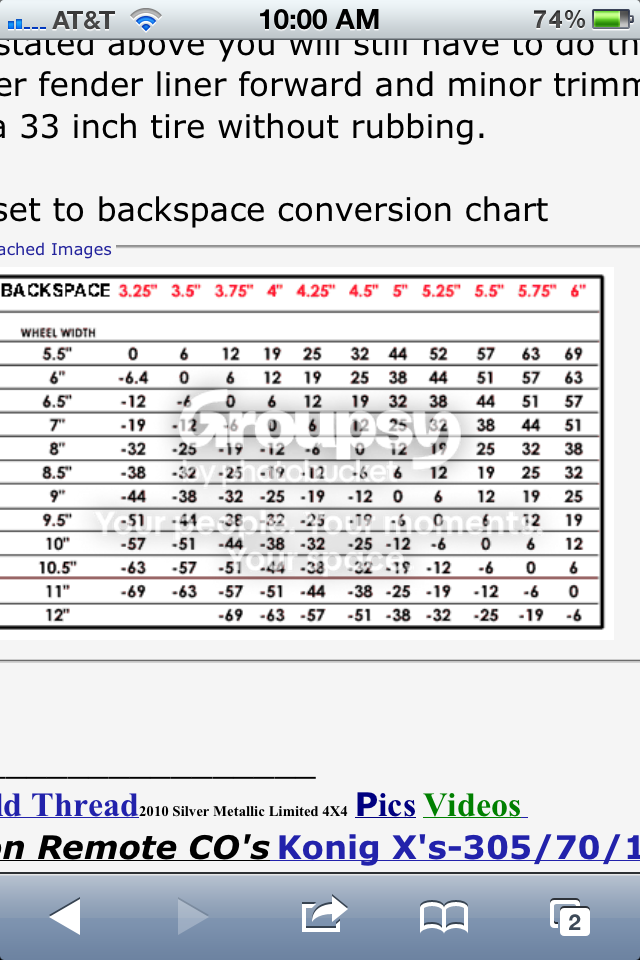

I'm getting 17x9 with a -12 offset Level 8 Strike 6. That equals out to a 4.5" backspacing. There's a chart that's very useful I have saved. When I get home I'll post it up.
I think that size gives the best stance, no spacers needed, an clears 231mm brakes.
Here is that chart I was talking about. I've seen it around a few times. Tacoma world has a few good threads on tires and wheels...pretty helpful.
