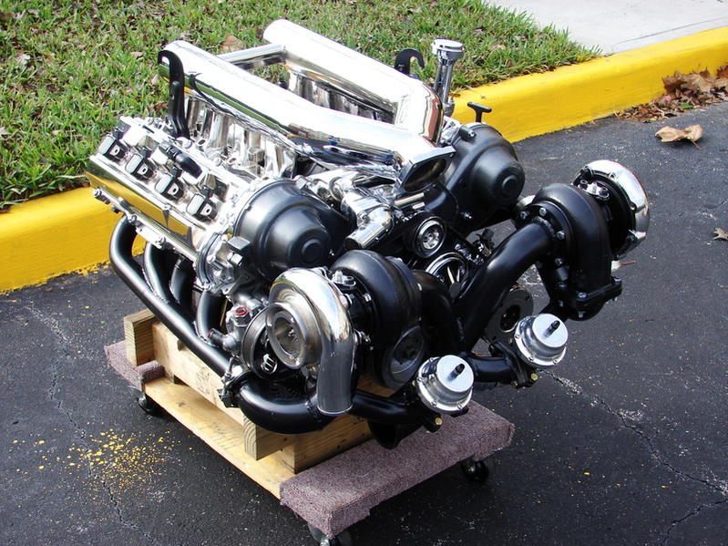

I havn't heard many reviews of the TB spacers being worth wild, The intakes on these trucks are already cold air setups they just lack a high flow filter. If you plan to go in and add new pistons to the engine then you have a whole world of options to build this engine... let me get you to a company you may be interested in....
TTC Performance 1/2/3uzfe twin turbo kit
^^they make our engines look like this....

I want to beat every car or truck in a drag race. And that wasn't even my runner.... I just creamed on the supercharged engine but the engine with twins is beautiful! Im not trying to put together this engine with stuff in a ctolog, im going by what people on this website have done and what works.
