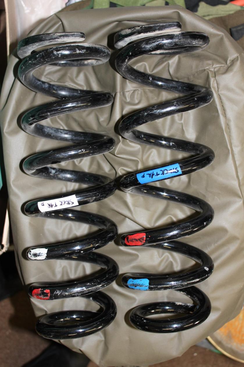

Springs carry the vehicle weight. Shocks dampen the spring movement. Your issue has nothing to do with your shocks. Try a 10mm trim packer on the driver rear spring.
4th gens are different, side to side.
7 coils driver side 6 coils passenger, slightly thicker coil on driver side.
