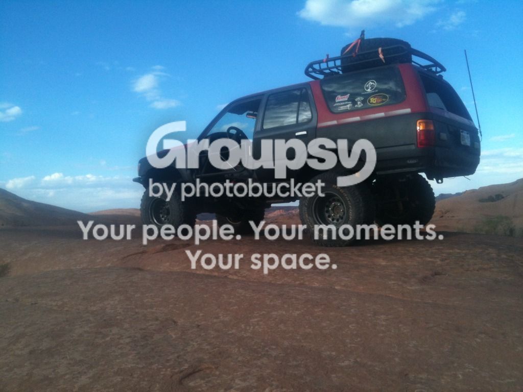

I had a great time last year learning all about offroading and learning how to drive under in crazy situations. I started with a stock 1991 4Runner. By the end of the year, I was lifted 2", armored partially, locked in the rear and tubed on the doors during the warmer months. So as it stands now, this is what she looks like.

Updated pic as of 10/11/13 with Wicked Trail Fab roll cage, custom sliders by SVD, chop top (still in the works. Up next is rear bumper, SAS and regear.
