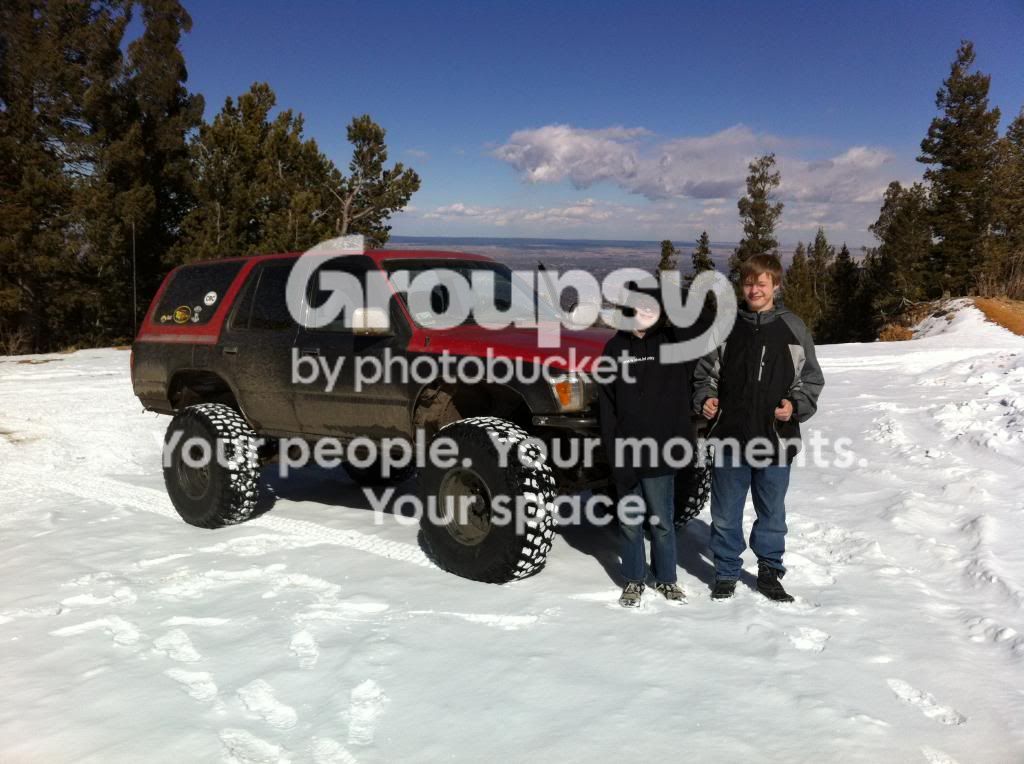

Took slave labor up Eagle Rock with 6-12 inches of snow at any given point, big nasty rocks, mud and loose gravel. The Minnow marched right up it as if it was a smooth highway. LOVE the new KM2's!!!!!

I figured out the rubbing. It is hitting the idler and/or pitman arms at full turn. No rubbing issues with up or down movement.

The tires look great, Bill! I can see you and SVD having some fun adventures this year! My first serious wheeling on KM1's was also in snow--a fresh 6" or so on top of mud (shh, don't tell--it was on my old CJ-7 many years ago). Drove wherever I wanted, including hill-climbs, stopped anywhere and took right off again--fantastic traction!
Quick review on the tires: They are great in 6 or more inches of snow! I can just plow through like it is a highway. As for snow that is packed on to the road, as thought, they slide quite a bit at 30 PSI. Might be better if I was aired down, but who knows.
