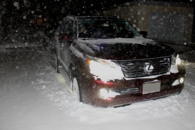

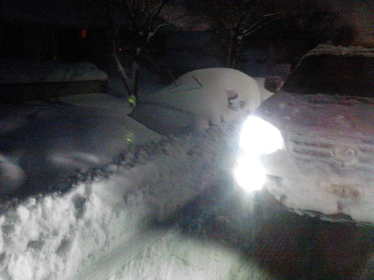

That's 400 lumens per bulb, 28 combined LEDs per bulb. You are correct about halogen and HID producing more light (lumens) but the VLEDs are nowhere near a marker light. I can not explain why they look so bright, but they do. I disconnected the headlights and lit only the fogs and the VLEDs lit better (fog pattern, and temp.) then the OEM halogen. They look just like Silverstars (brightness) but a little higher temp (OEM HID, 4300K). I have HID headlamps and the H11 VLEDs are a perfect match. Also they are plug'n'play and a LIFETIME bulb. I'm SICK of replacing fog light bulbs (and the cost)!
This is a bad cell phone pic but you can see the temp and brightness.

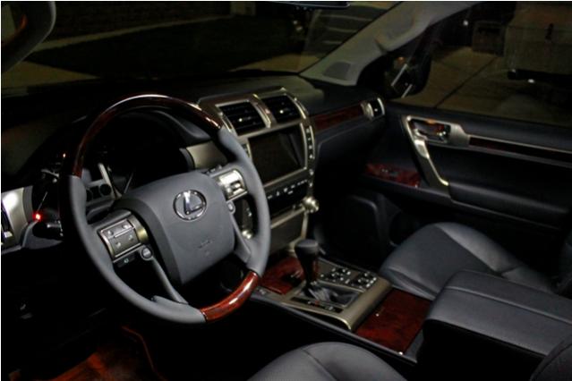

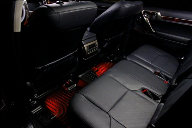

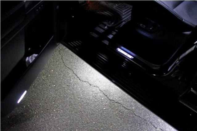

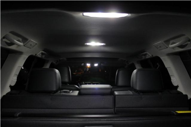

Some other LEDs pics.
