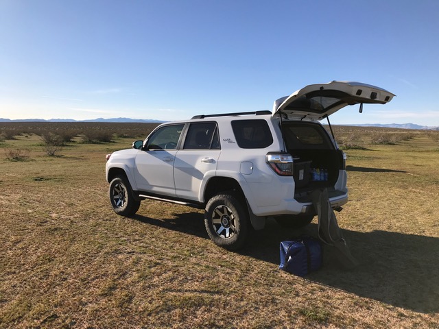

I have a 2019 TRD Off-Road Premium that I just fitted with 255/80/17 Toyo Open Country tires on OEM rims.
Shop advised (before starting the job) that I buy wheel spacers and that the spare would not fit. I told them i read on the internet that everything would fit fine so it must be true. :)
Well, it did fit fine, including the spare. I may have some very slight rubbing in the front wheel well plastic, but haven’t even bothered to push the plastic out of the way.
I do have a suspension lift too, and I think the new Icon UCAs do help with wheel fitment (but I can’t verify that for sure) since they allow for more caster angle adjustment.
Hope that helps!

Which lift are you running? I am installing a 3”/2” Dobinsons lift and considering the same tires on my TRD OR,but don’t want to be too tucked under. Flush with fender and no trimming is my goal.
You'll be fine I have only bilsteins at 1.75 in front and running a true 33" tire with zero issues at all. The tires dont feel skinny but that 1/2 inch or so in width goes a long way with space. I also have plans of a 100k mile bday gift of full cushy set up in a few years.
