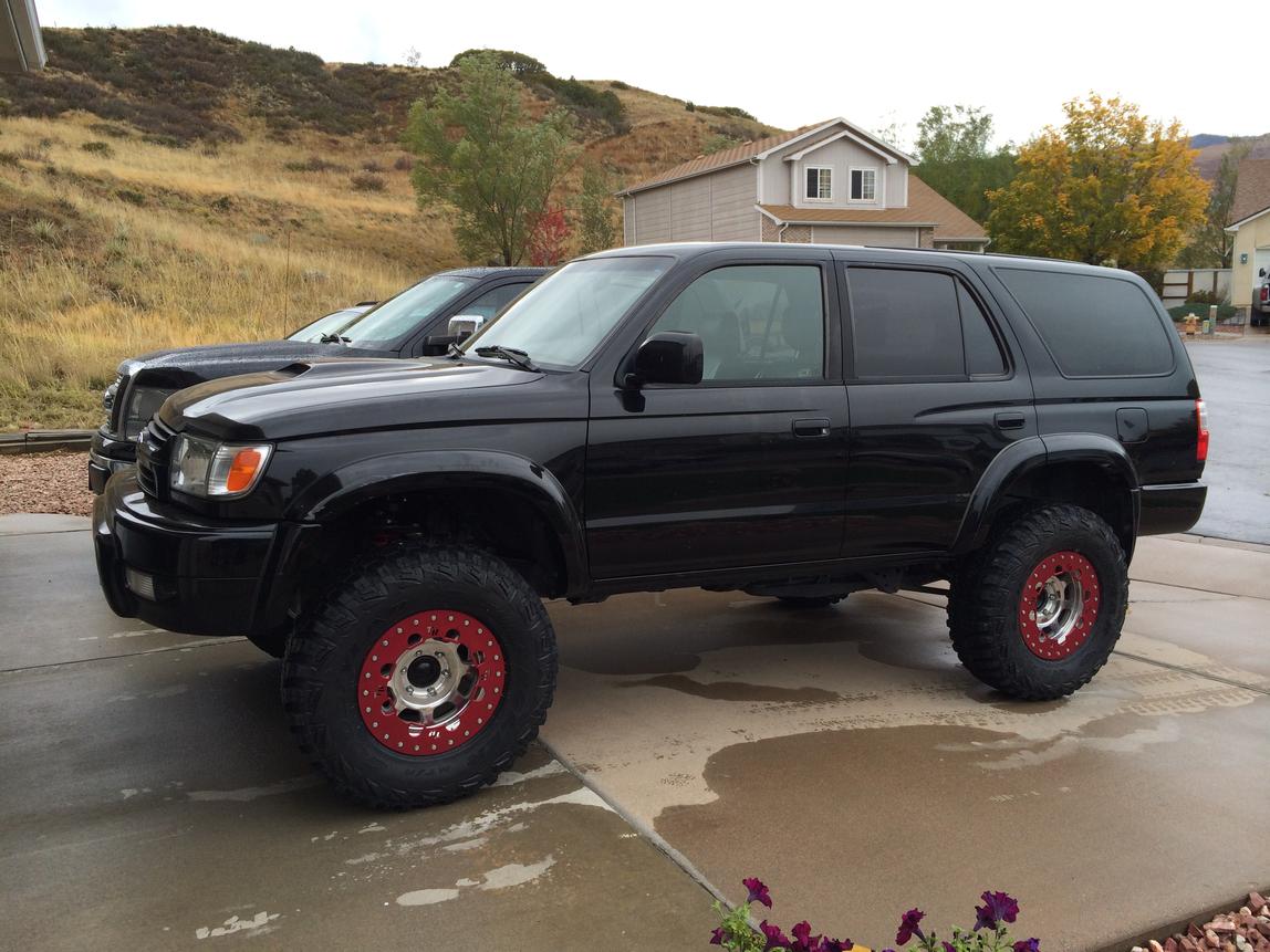

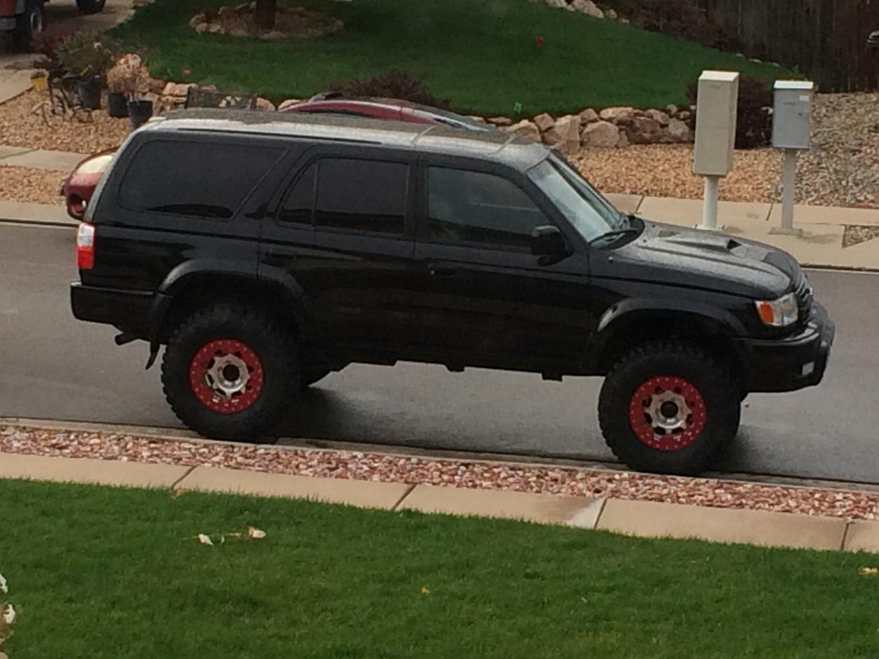

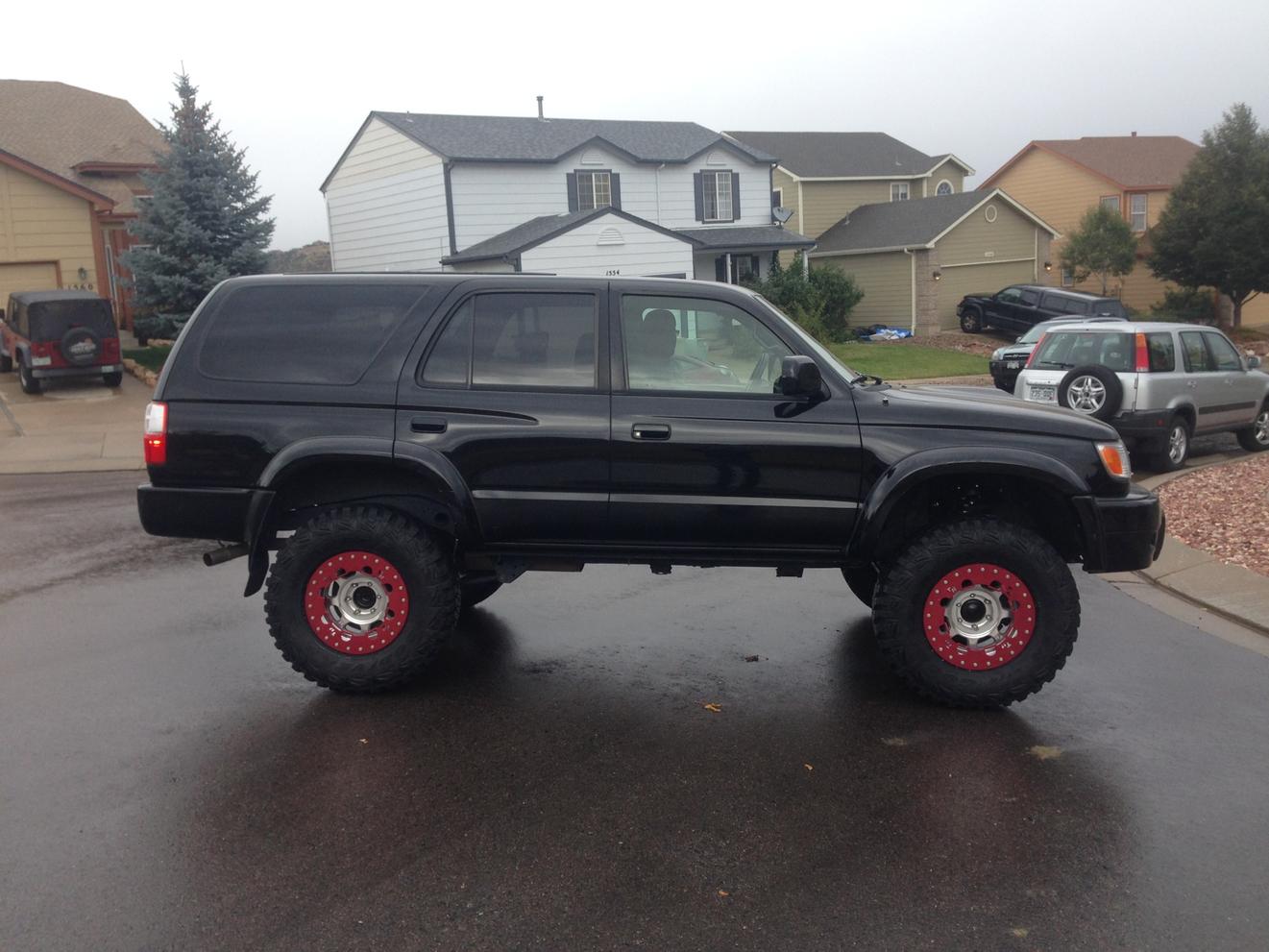

Here is mine after the lift. I'll and get some measurements for you later.

Do you mind if I ask what your front setup is? Looking forward to measurements!

Front is the Toytec Boss, with 600 coils. Since the pictures I have lowered the front a bit. I took the measurements in my garage which isn't perfectly level but I have 24 from the center of the hub on the passenger side and 23.5 on the driver side. Also it is important to note that I am not running the cones.

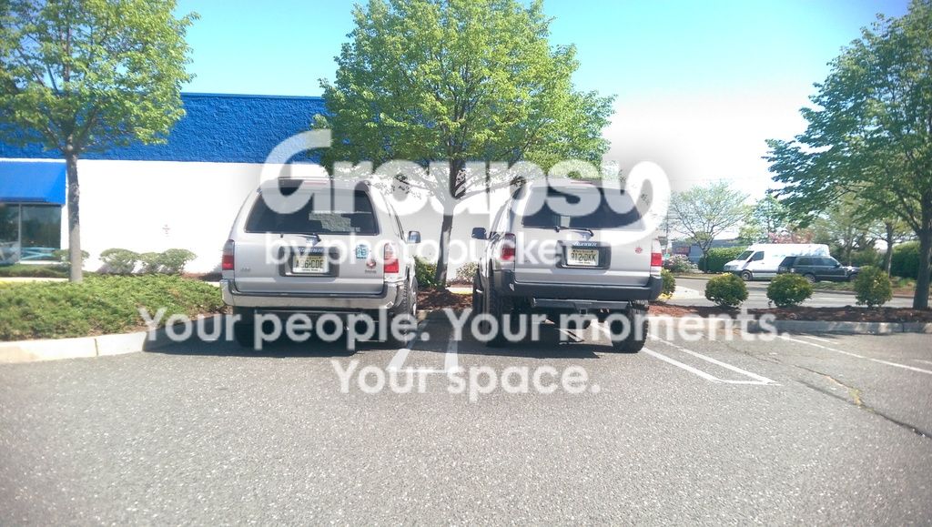

Mines on the right next to stock 4runner. I got eibachs with Tundra 5100 on 2nd perch and superflex on rear

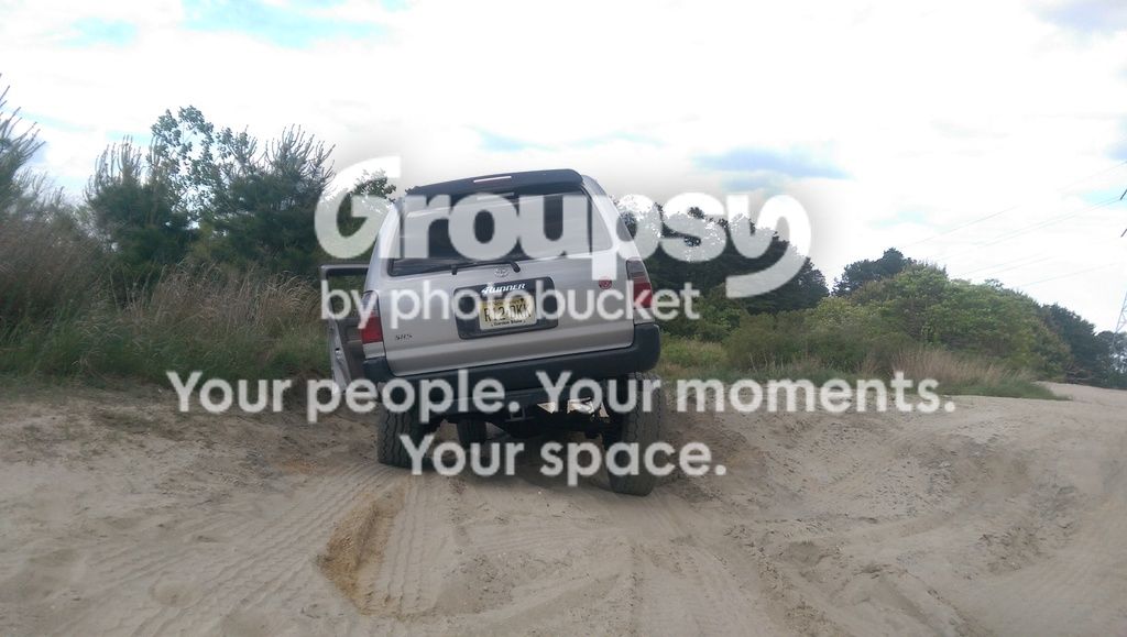

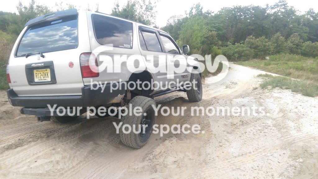

Nothing crazy but good flex
One side of my rear sway bar is broken so its disconnected. And so at a good flex the drive shaft hits the gas tank skid plate. I either need to bent the skid plate, install longer links or adjustable panhard. Keep in mind I have ss extended bump stops and panhard drop bracket
