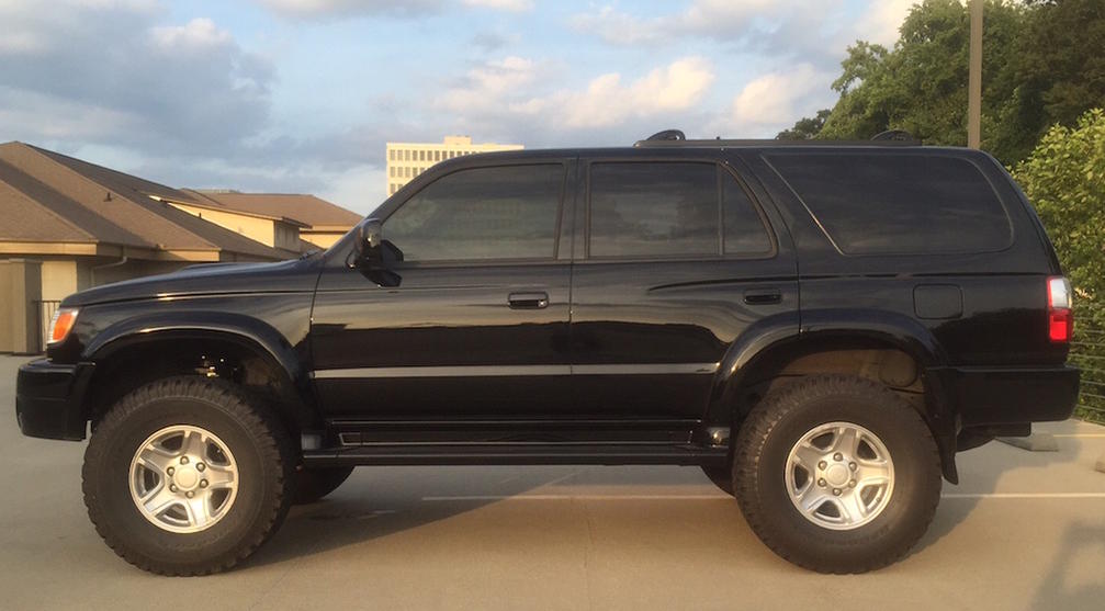

Mines on the right next to stock 4runner. I got eibachs with Tundra 5100 on 2nd perch and superflex on rear
Nothing crazy but good flex

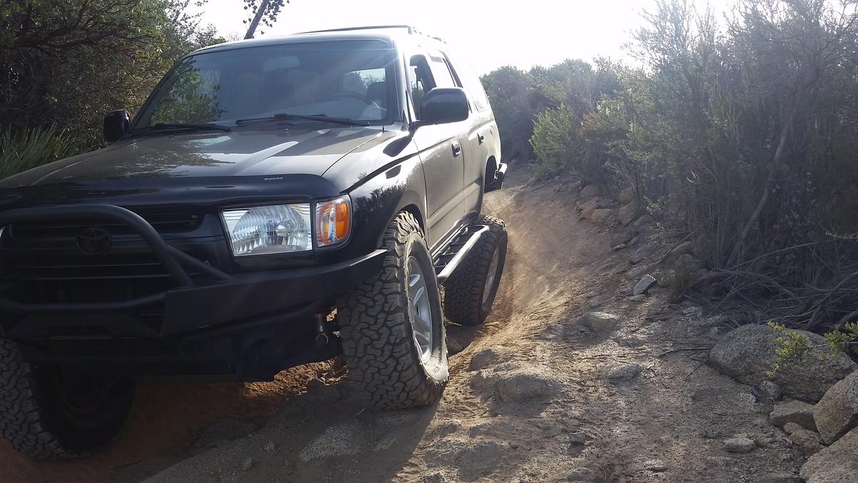

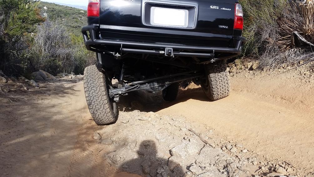

One side of my rear sway bar is broken so its disconnected. And so at a good flex the drive shaft hits the gas tank skid plate. I either need to bent the skid plate, install longer links or adjustable panhard. Keep in mind I have ss extended bump stops and panhard drop bracket
Issue with lc coils and and such you will always flex into tank. Best bet is hammer the shield. You can help it with parts but nothing less than gas tank relocation will completely fix the issue.
Superflex coils, bilsteins, and Sonoran Steel extended bumpstops at full flex.

mid hub to fender with factory cones: in the pic i have about 100-150lbs of tools in the rear
front ~23.25"
rear ~23.50"
with cargo area completely empty ~23.75"
Ride quality: Slightly stiffer than 890s. The slightly stiffer ride compared to my 890s was worth the .5-.75" gain in rear height. Have not experienced coil slap with on road driving & had them installed since May 2015. Yes I would highly recommend.
