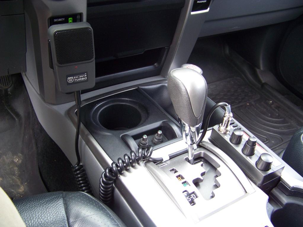

I use my CB on the road as well as during offroad trips so I mounted it here, close at hand. It really is pretty unobtrusive here. I like it.

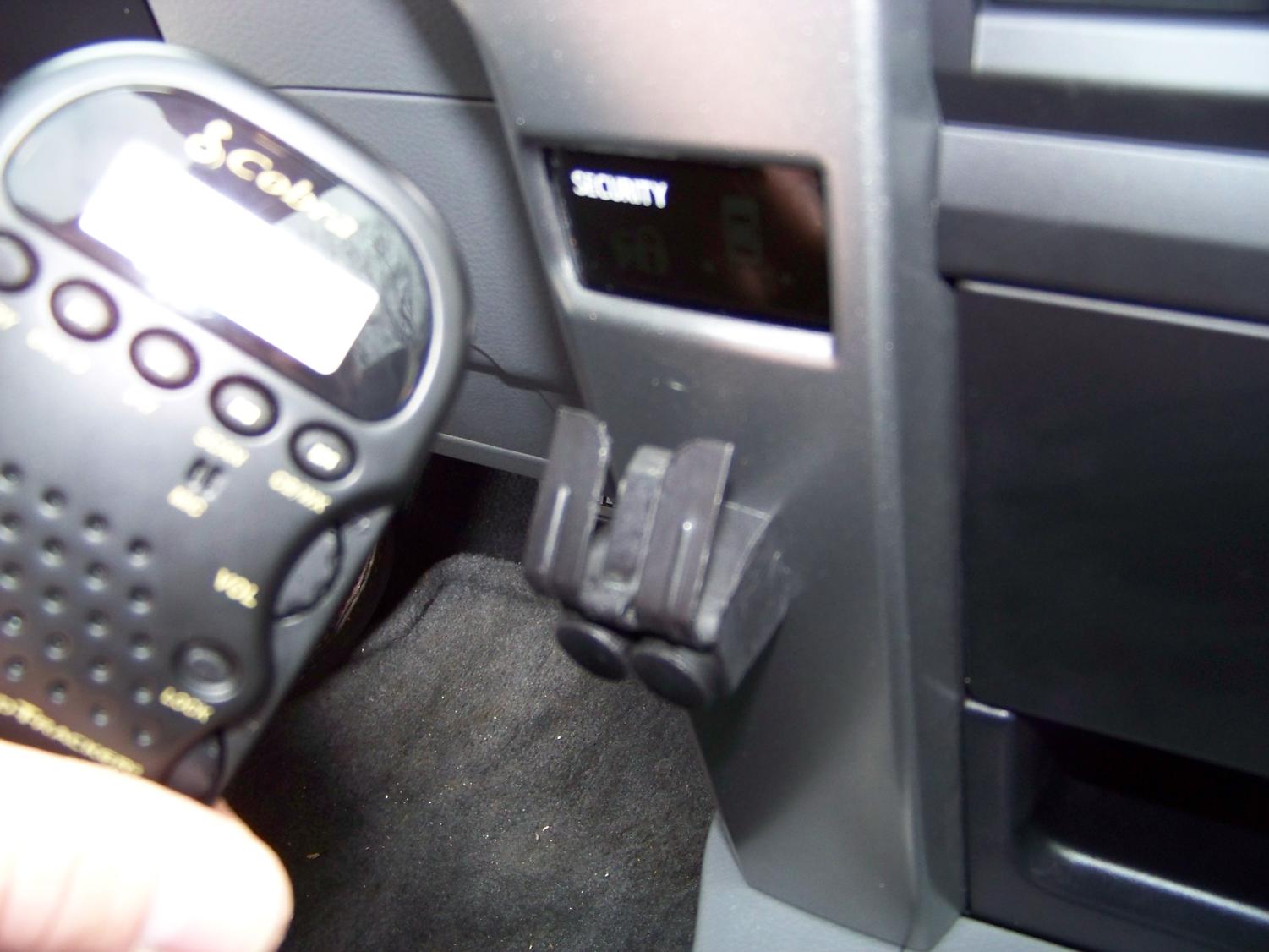

Second awesome picture shows how I mounted the clip (ignore my old CB). I used some stick epoxy and molded/filed it into shape as a standoff. Not really necessary, but I think it looks better hanging straight.

Mine is on the console itself, facing up, and you pull it towards the back of the truck (towards the driver) to release it. I used a decent mic clip though, a Motorola unit that actually retains the mic via a piece of spring steel and a dimple. I have the cord wrapped around the transfer case shifter to keep the slack from flopping around.

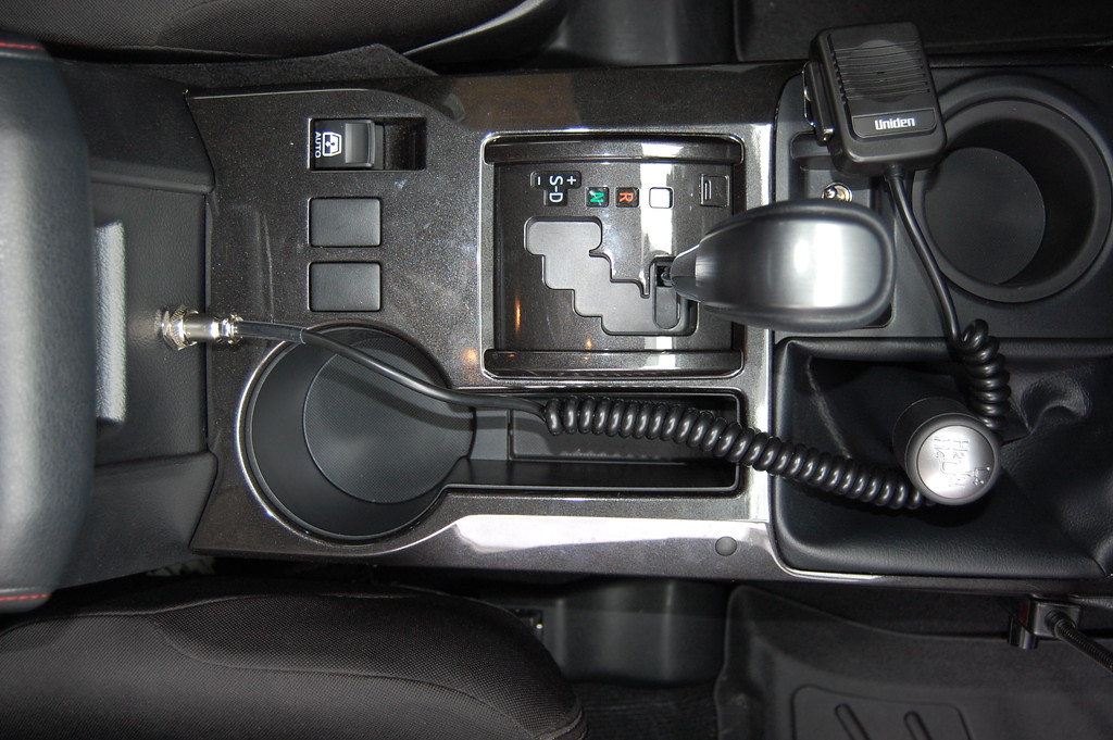

At the 10:00 minute mark you get a good view of it, then at 12:00 minutes I go into more depth on the CB. The Uniden CB I purchased came with a very simplistic mount for the microphone. I installed the CB radio against the center stack area on the passenger side and the microphone a little further up on the side of the center stack. I screwed in the radio and glued on the microphone mount - both are holding up beautifully after several trips.
Given a second chance at mounting everything, I'd do it exactly the same. I really like the location for the microphone and the CB itself. Both are quickly and easily accessible but do not interfere with anything else.

Basically I kneaded it into the rough shape you see and pressed it against the dash to get the exact contour. Then I set it aside to dry- about 1/2 hr. After it was hard, I used a belt sander to make it look pretty. Drilled holes through it, painted it black and mounted the mic clip through the epoxy into the dash.
