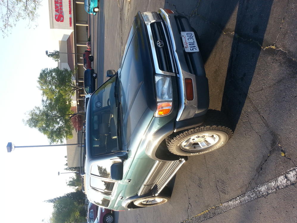

i picked up a 1997 toyota 4runner limited for $1800
original owner and plenty of records. but it has 308k miles and he said it might not pass smog.
ive had a couple toyota trucks/4runners before so i wasnt scared or worried about it . it drives fine. everything works. leather. its nice, i couldnt pass it up for the price. ive been wanting a toyota again. and i just happened to come across this one .
i took it to a no pass no pay smog shop, and just like he said it didnt pass! for high knocks no2 at idle speed.
luckily i work at a Napa Auto Parts. and i get 10% above store cost. so i did a basic tune up:
oil change, fuel filter, spark plugs/wires, K&N intake. sea foam liquid in the tank, sea foam spray into the intake.
ran all the additives thru the truck and got fresh chevron premium gas and took it back to the smog shop. But...... unfortunately it did not pass again, even tho it got a lot better than IT WAS....A LOT BETTER!!!. i talked to the smog guy. he said its in the fuel management and its running too hot and lean.
so i did some research and decided to do the fuel injectors. with my discount. its not that bad and thats where the clues lead me to.
did the injectors and plenums. AND IT PASSED. the emission look great now
put about $300+ into the runner
$2100 for the 4runner all said and done... im STOKED!!!!!

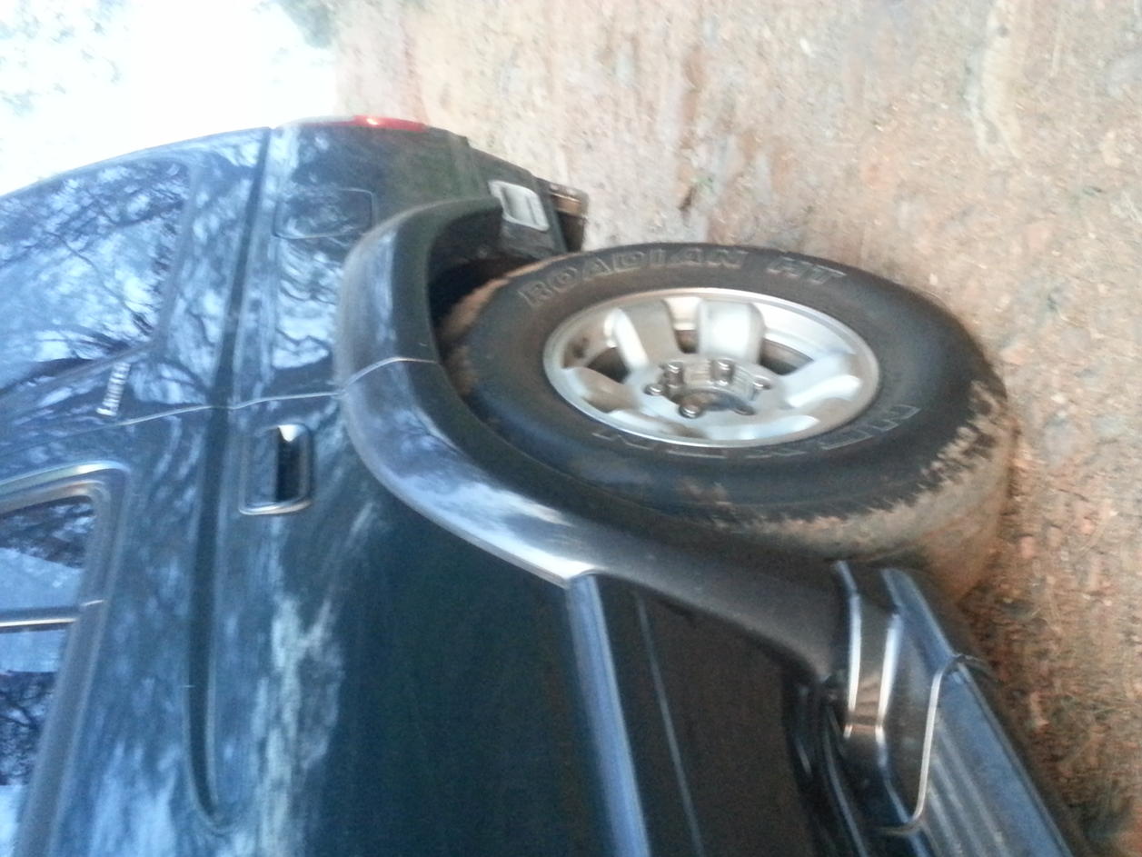

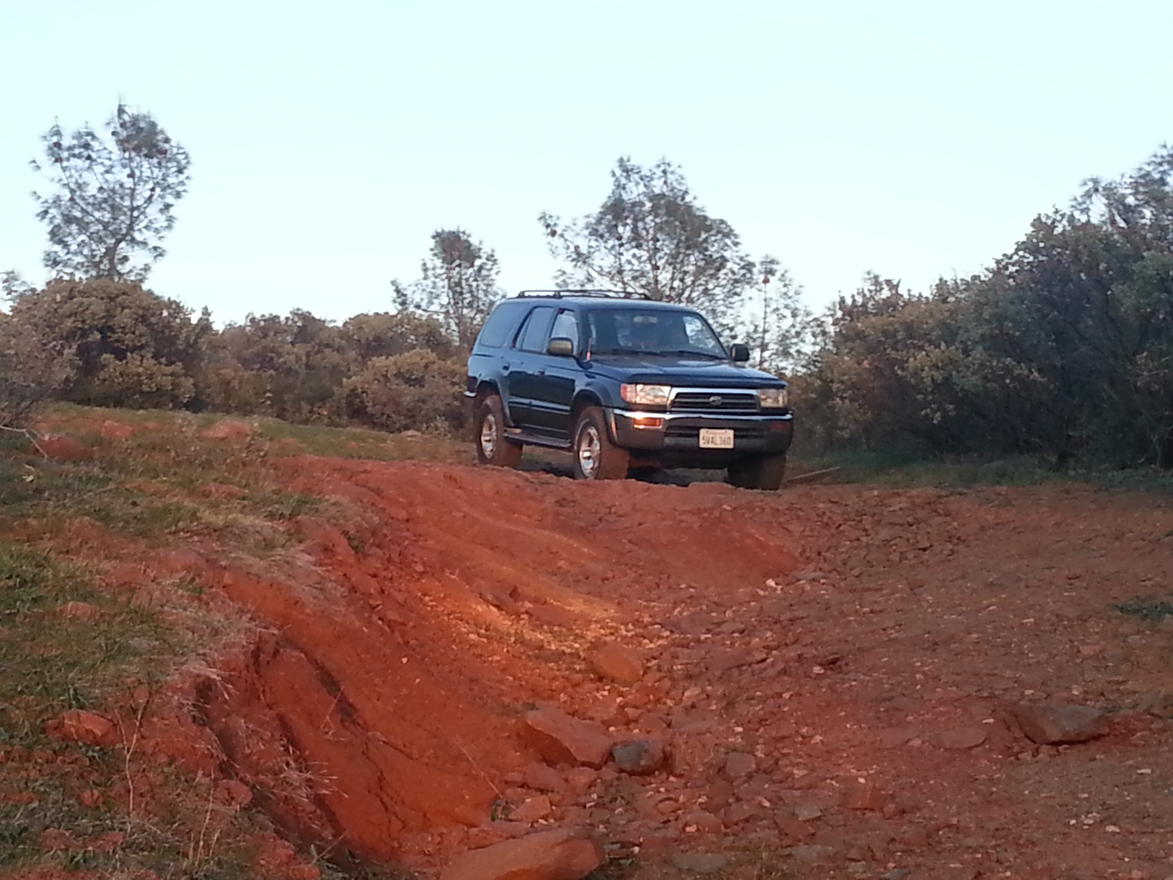

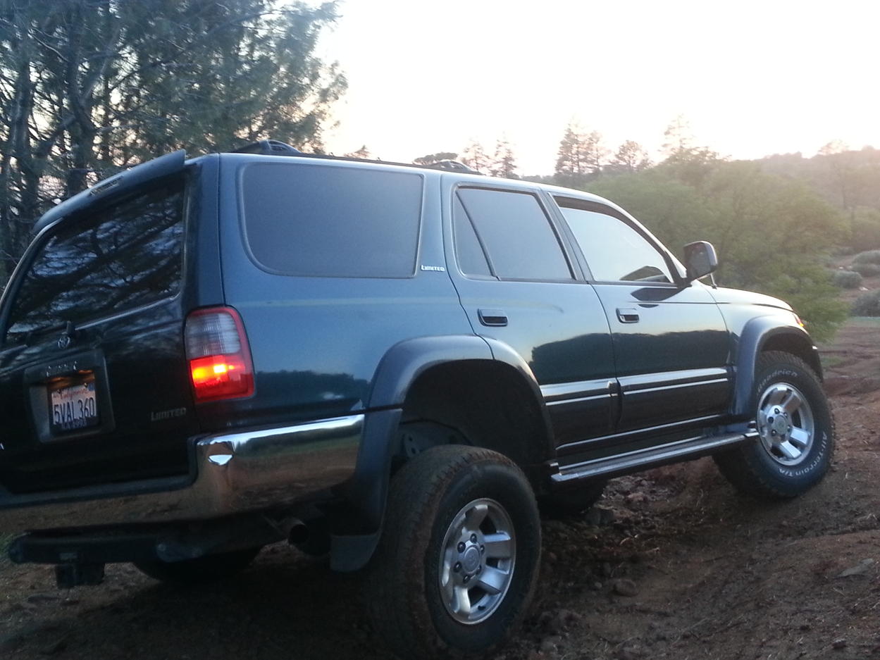

took the runner out to a little spot (cameron park). thats not too far away and not that difficult either. still stock suspension. wtf why wont it rotate the photo..
