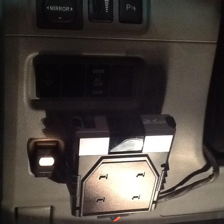

I used a "BULLY" brake controller. It had to be wired with a kill switch or else it was always hot. Although, Even with that switch in the "off" position, trailer unhooked, the controller lights up when pushing the brake pedal. I'm sure it's feeding from the brake switch circuit. Maybe mine is back feeding through that controller some how. I really don't know at this point. Like you, I tested twice to be sure and mine stays connected with the truck off. Will check the 7 pin after work, looking at what's hot, key on or key off.
Great, now you have me pondering how mine is the oddball hahaha.
Did you use the brake controller adapter/harness that came with your truck? I'm using the Tekonsha Prodigy with a wiring adapter made by Tekonsha. The wiring adapter plugged right to the back of the brake controller and then right into the harness on the truck; no soldering or connecting of bare wires needed.
I just went out to the garage to double check, and my brake controller definitely turns off when the truck is off.
Ok, you are absolutely 100% correct and I was wrong. The pic below shows the 3 position switch installed to turn off/on my brake controller and using the 3rd position, jump the + trailer terminal. No excuses like: "senior moment" or "I've slept sense then" would help at this time I guess.
