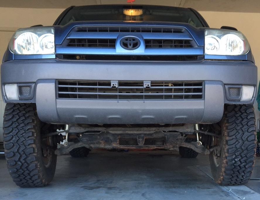

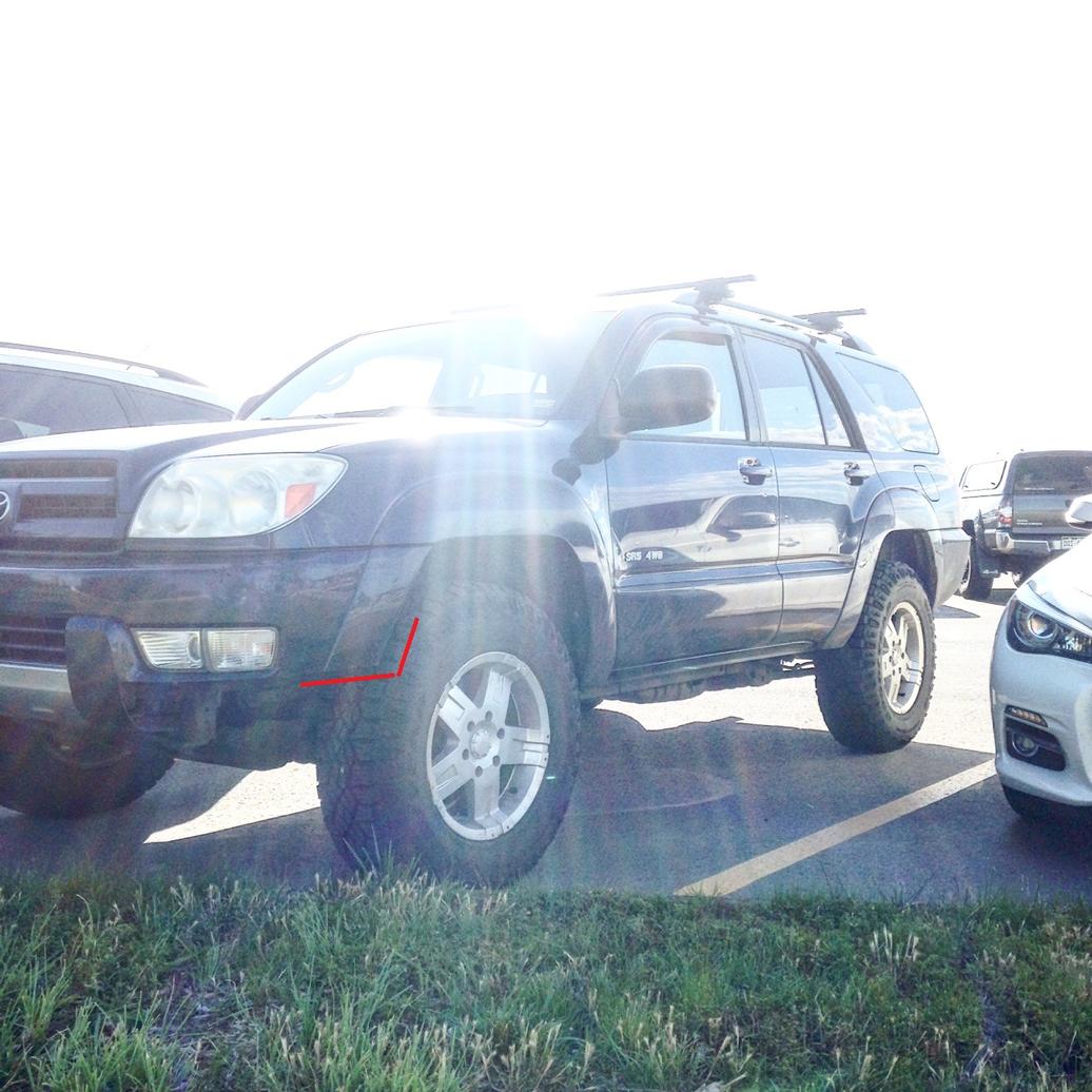

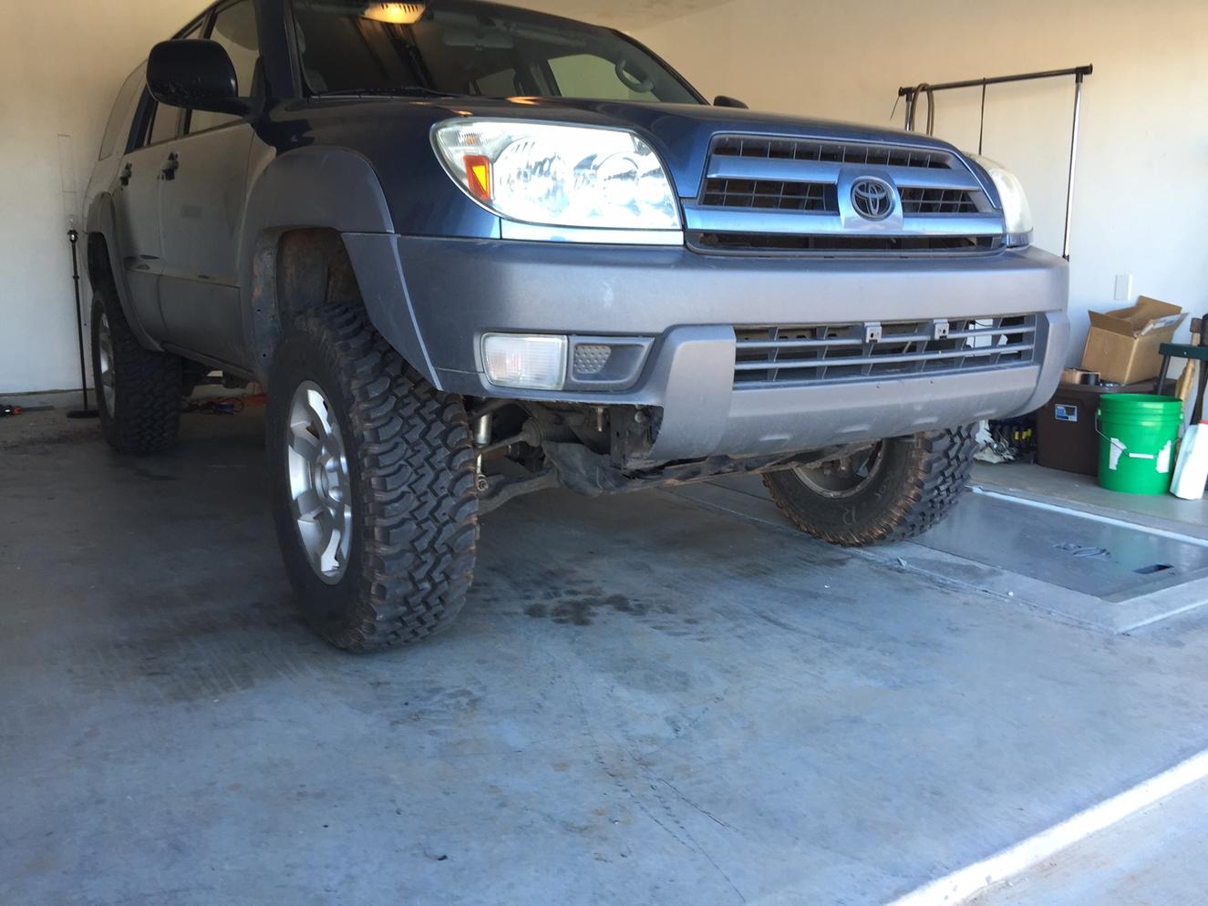

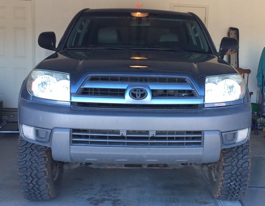

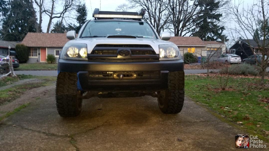

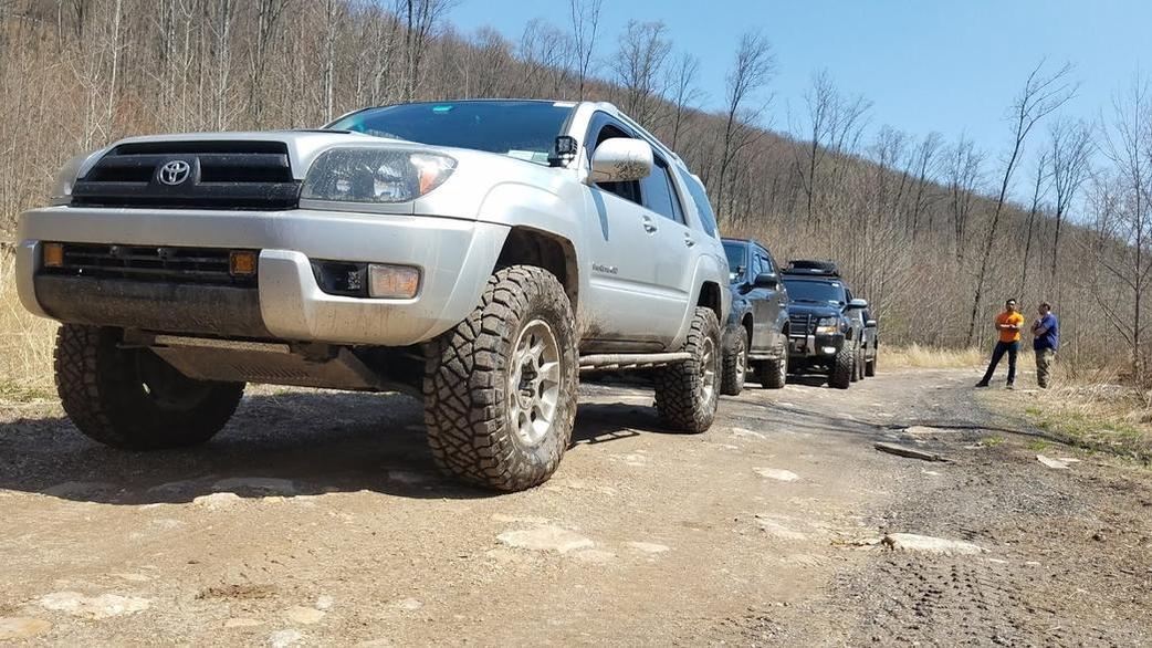

@ tman and original.. You guys have a side shot of thw whole 4runner? I just trimmed up my front bumper aimilar to you guys but left it straight across and didnt taper the flare up higher.. Curious what it looks like before i keep cutting
I do not, sorry. I got rid of the truck about a year ago and have no pictures on my phone. From the side it looked off. By that I mean the lines from the rear and front didnt match. The front bumper looked much higher than the fat, low rear bumper. As far as approach angle goes and tire clearance, worth all my time and Id do it again as a money saver.
I also did the Tman chop.
I didn't do the upward cut in the fenderwell, just kept my cut level with the ground and went straight back to the front tires. I've run the Tman chop for a while now and I love it.

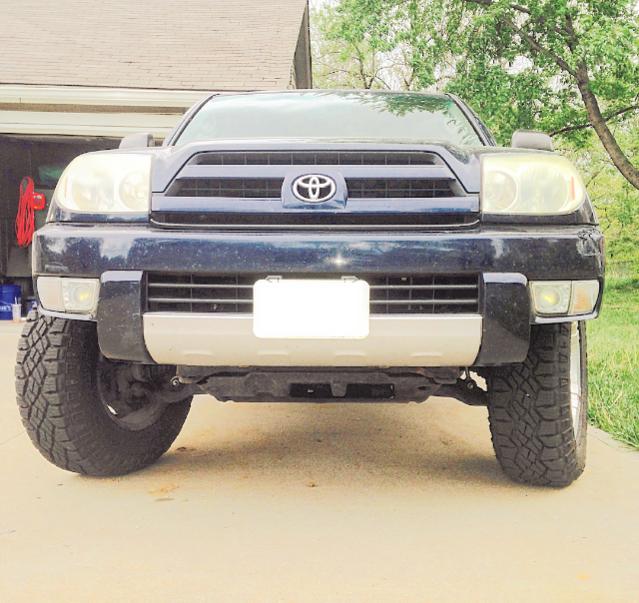

Got really bored at work, ended up coming across this thread and.....
Sent from my SM-G892A using Tapatalk

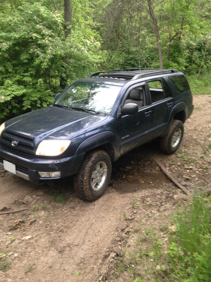

Does anyone have any pictures of the inner fender liner? What are you guys doing with that?

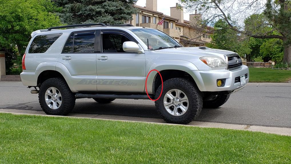

I hope this makes sense. Lets see pix of what and how much you all have trimmed on the rear, of the front fenders / flares.
Hope this pic better explains where in talking about, I want to see what you all have done.
Thanks in advance

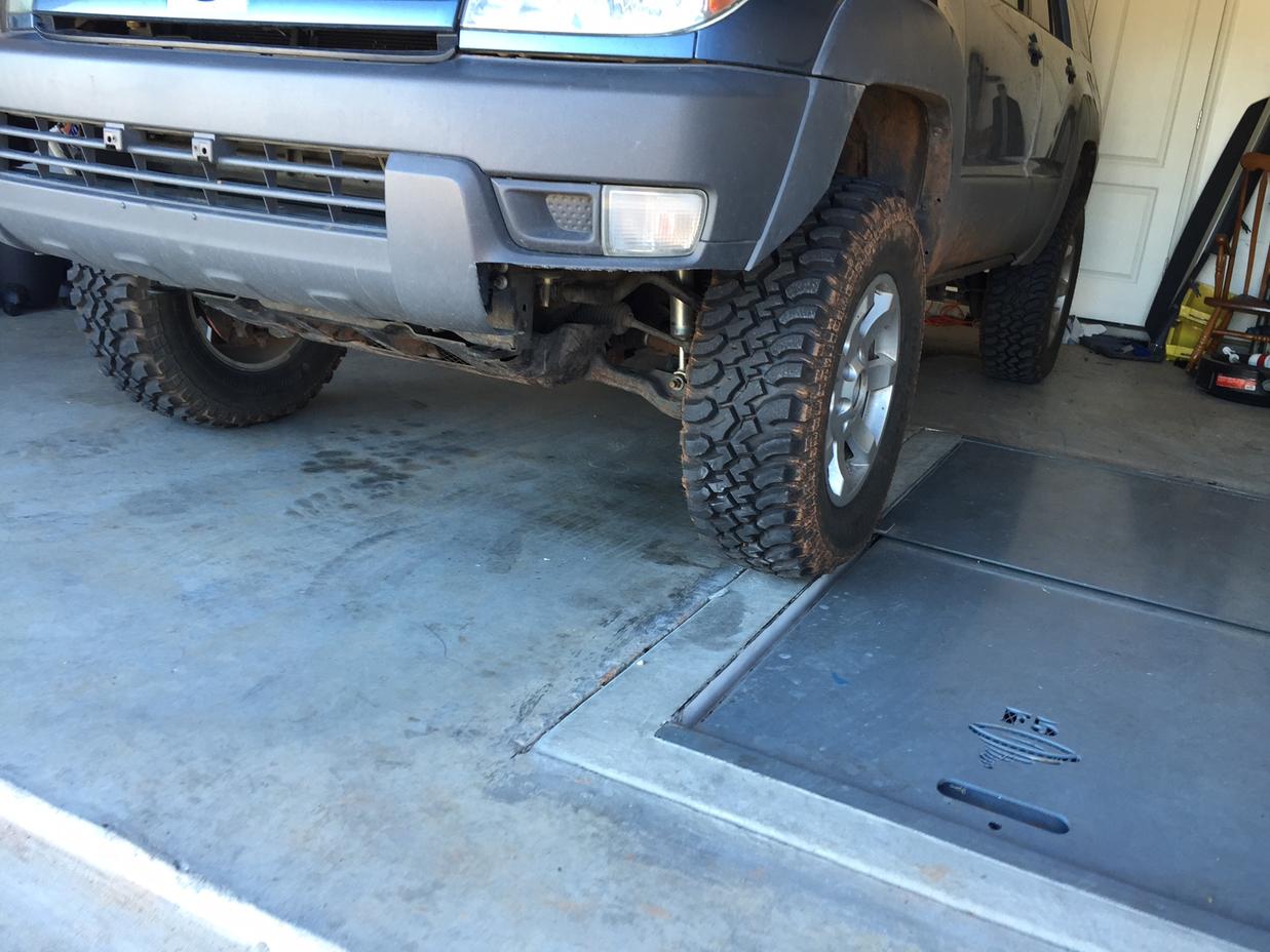

Thinking about doing this bumper chop but I want to cut out the factory fog and turn lights and add in flushmout light into the bumper to replace them. Has anyone seen this before? Might give it a look closer to having a winch bumper. I would get rid of the whole lower section but I have a hidden winch and need to keep the center bumper grill section.
This is an idea of how I am thinking about trimming my bumper.
Excuse the poor photo editing attempt. Best I could do on my phone without a stylus. You can see some tape from where I had masked off where I was thinking about cutting to see how it would work.
