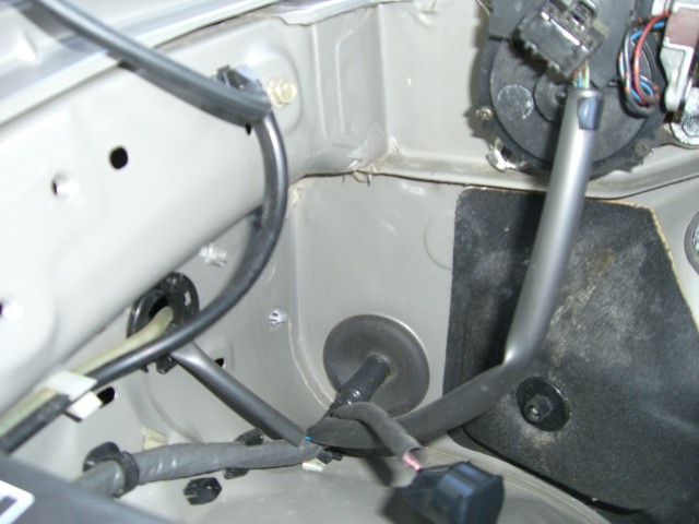

Here is the 1st pic showing the Buzzer that produces the sound. The Buzzer is located on the passenger side fender in the engine bay near the back. (Notice in the pic, I've already removed the plug to it.)

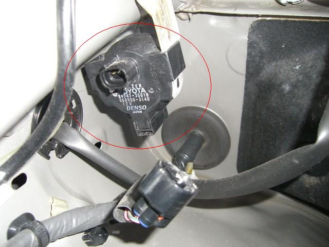

Now just unplug the wire to it. Simple as that. I went a few steps further and removed the buzzer all together, since I'll never need it. There is only 1 bolt holding it in, so remove that take out the buzzer and put the bolt back in for a clean look.

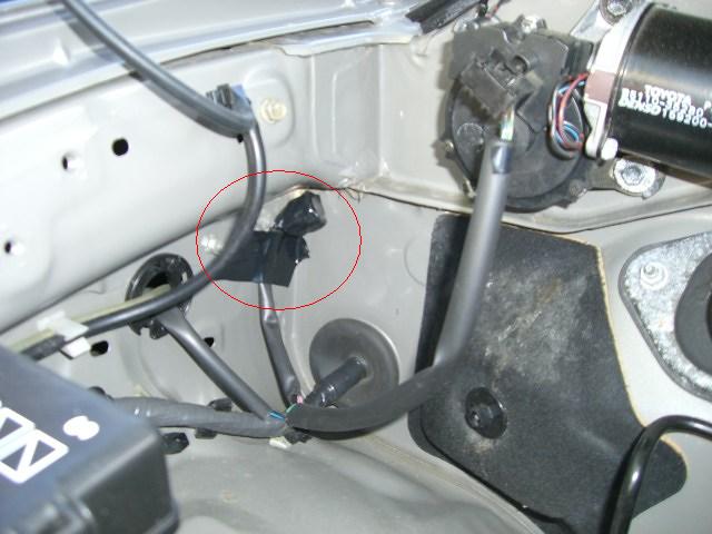

**UPDATE**
I've since removed the tape and took Lee's advice and zipped tied the flopping cord to the hose on the left of the picture. (Sorry no pic of the zip tie :D)

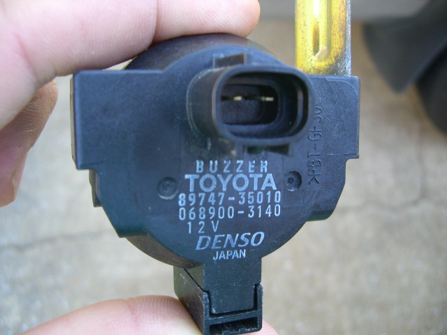

And last, here is a pic of the part I have removed:
Now everytime I unlock/lock or roll down my back window using my remote, there is no "BEEP" associated w/ it! Very cheap and easy. This job gets a 1/2 bannana on the bannana scale.

hey if i were you id ziptie that wire out of the way, rather than tape it.
esp where that tape is, it WILL come off.
otherwise, nice job man, thanks for the info.
Thanks.
Yeah, I'll probably zip tie it to something later. I didn't have any zips laying around, but I had plenty of tape laying all over the house!

Well Lee you're right about the tape, that stuff is barely holding on! I went digging in my garage and found a zip tie laying under my work bench! (I knew I had some laying around.) I just zipped the plug it to the hose to the left of where the buzzer was.)
