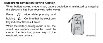

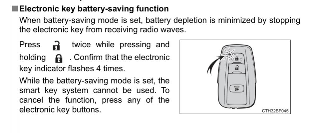

As to the physical button on the MDX vs the groove of the Toyota door handle, Toyota’s version is absolutely waterproof.
Waterproof yes, but when I wash my car, with the key in my pocket nearby, the car will lock or unlock when my hose hits the sensors. I've learned to leave my key in the house when I wash my car.
Does it do it when it rains?
I've washed a lot of pushbutton start Toyotas and never had that happen?
I just made a deposit on a '23 TRD Off Road Premium w/KDSS yesterday, so we'll see what happens the first time I wash it - sometime in mid to late July when it gets here. It's taking the slow boat to the east coast.
You can temporarily disable the radio in the key.
