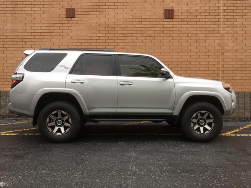

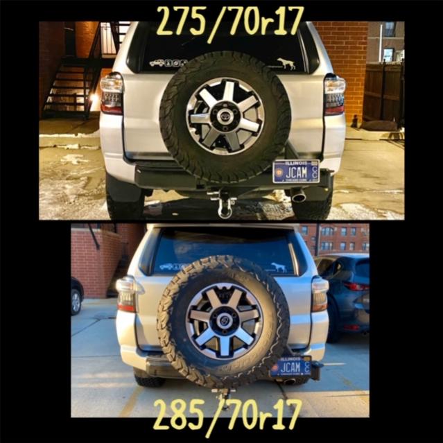

Here's mine.

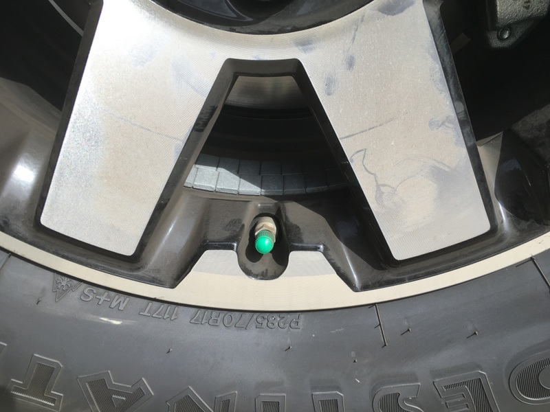

Guys, I don't know if it is the pictures or what. My 2020 trd offroad wheels look more shinier then a lot of the ones in this list. Some of the pics the wheels looks like a machined metal color or is it just the pic?

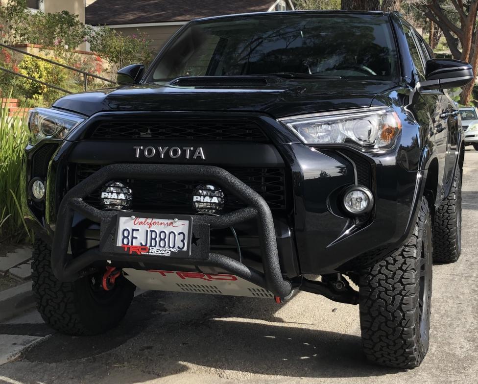

I have Nitto Ridge Grapplers in that size and I rub at full lock. You can see it on the most outer part and bottom there. Enough to take the powder coat off.
I don't think I rub too much now that a shop gave me some positive camber or just at 0.0 from what I remember.
Edit: on yeah, on stock trail wheels with no spacers.

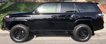

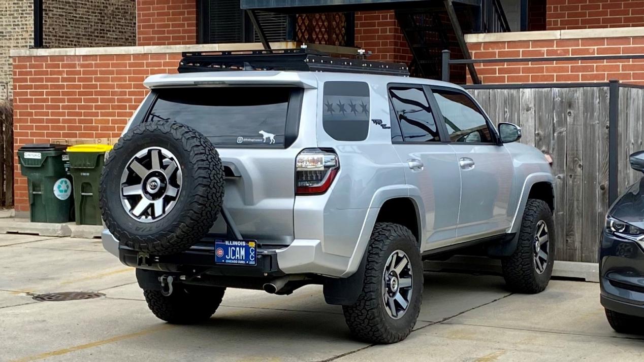

Here is mine. I use 1" Bora Wheel spacers. Had to do some minor trimming on the front bumper, but not noticeable to 99.9% of people.

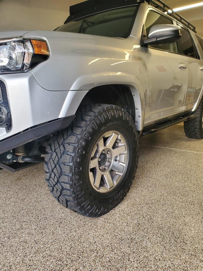

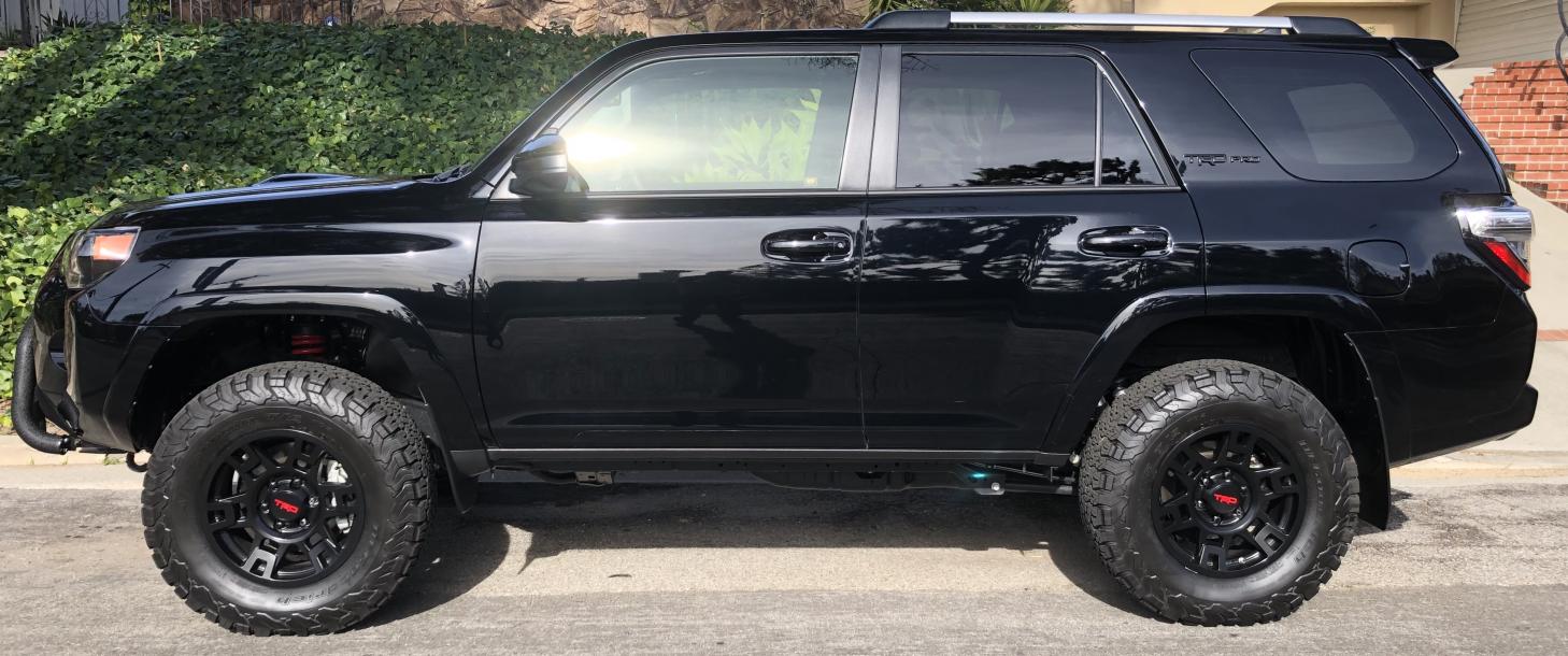

I have a Pro with the Pro wheels running 275’s. I added 1.5/1” spacers which makes it about 2.5” up front as the Pro is 1” higher stock than the other 4Runners. It also comes with the front fender liner mod done at the port. I did not have to mod or remove my mud flaps and have no rubbing at full articulation off road.

Next time around I will probably run 285’s. Plenty of Pro’s running 285’s with a2/1.5” spacer lift and no rubbing. The key is the offset of the Pro wheel. I use to run 285/75-16’s, the equivalent of 285/70-17’s on my 2001 4Runner on 16x7” oem wheels and could air down to 15lbs. without issues. I had a slight rub after years of use on the UCA that left a mark like the previous member showed on his UCA.
Are you using 1" Bora spacers all around? I haven't pulled off my wheels to measure the stud length, any issues with clearance on the studs. This spacing looks perfect balance of clearance while staying under the factory flares.
Also, Are you still running only a 1" spacer out back.
