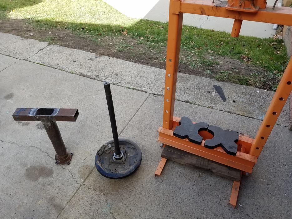

I didn't use the bearing splitter. I made my SST with a piece of axle housing and some rectangle tube, bolted the axle assembly into the housing and hung it in the press. The bearing and backing plate hold the ABS ring and retainers in place and the axle slides out like butter as long as you remember to take off the snap ring first ;). Put some wood under the press so you don't jack your wheel studs when the axle falls out out.
Now you've got a backing plate and bearing sans axle shaft and some loose retaining rings and ABS cogs. Since you're replacing the bearing anyway, drive it out of the backing plate with a drift and a hammer. The new bearing goes into with a set of bearing/seal drivers (I used the cheap HF set), you can do this with the press but I just tapped it into place with a hammer. Slap the snap ring back into place. Now grab that handy chunk of 2x2 receiver tube you've had kicking around the scrap pile and use it to drive the retaining collars and ABS cogs back into place, at the exact depth from the snap ring that your old ones were sitting at.
You did remember to measure that, didn't you? No worries if not, you'll just need some trial and error with a little grease to get the depth right on the retaining collar that rides on the oil seal. Get that depth wrong and your leak will come back and you will start kicking puppies.
Thanks for the pics and information. The one question I have for you is what is the axle resting on when your pounding the bearing, ABS ring and retainers on? Is it just resting on the wheel studs? If so, are you risking knocking the studs out of the axle while using this method?
Yup, wheel studs on a block of wood. The force needed to move six wheel studs at the same time is more than what you need to drive the bearing and collars, my studs didn't budge at all.
