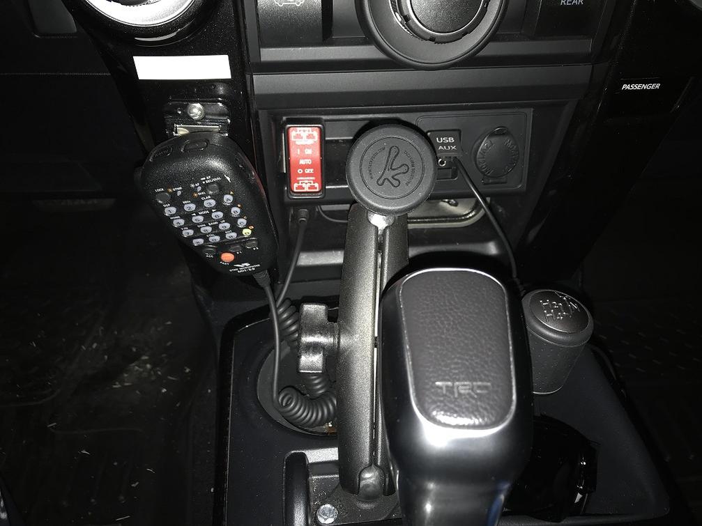

My installation is still a work in progress.
I'm waiting on getting a cargo rack installed before doing anything permanent with the antenna installation but this is where it is at temporarily..
[MENTION=157339]Coyotegray[/MENTION], would you mind sharing more details about how you mounted your unit on the ceiling against the lights?
The radio is an Yaesu FT-857D. It comes with everything needed to remotely mount the control head.
That area of the headliner is reinforced with thick plastic so I was able to just use the screws that came with the radio to mount it to the head liner. The cable runs through the overhead console along the top/left side of the windshield under the headliner down the post, under the lower door opening trim to the radio mounted under the drivers seat.
I ran an extension for the mic from the radio up through the center console to the cubby hole under the A/C Controls where I can plug in the mic.
ETA: I also ordered an external speaker but it was to big to mount in the cubby hole so I removed the speaker from its case and it fits ok. Needs some more work but you cant really even see it.
