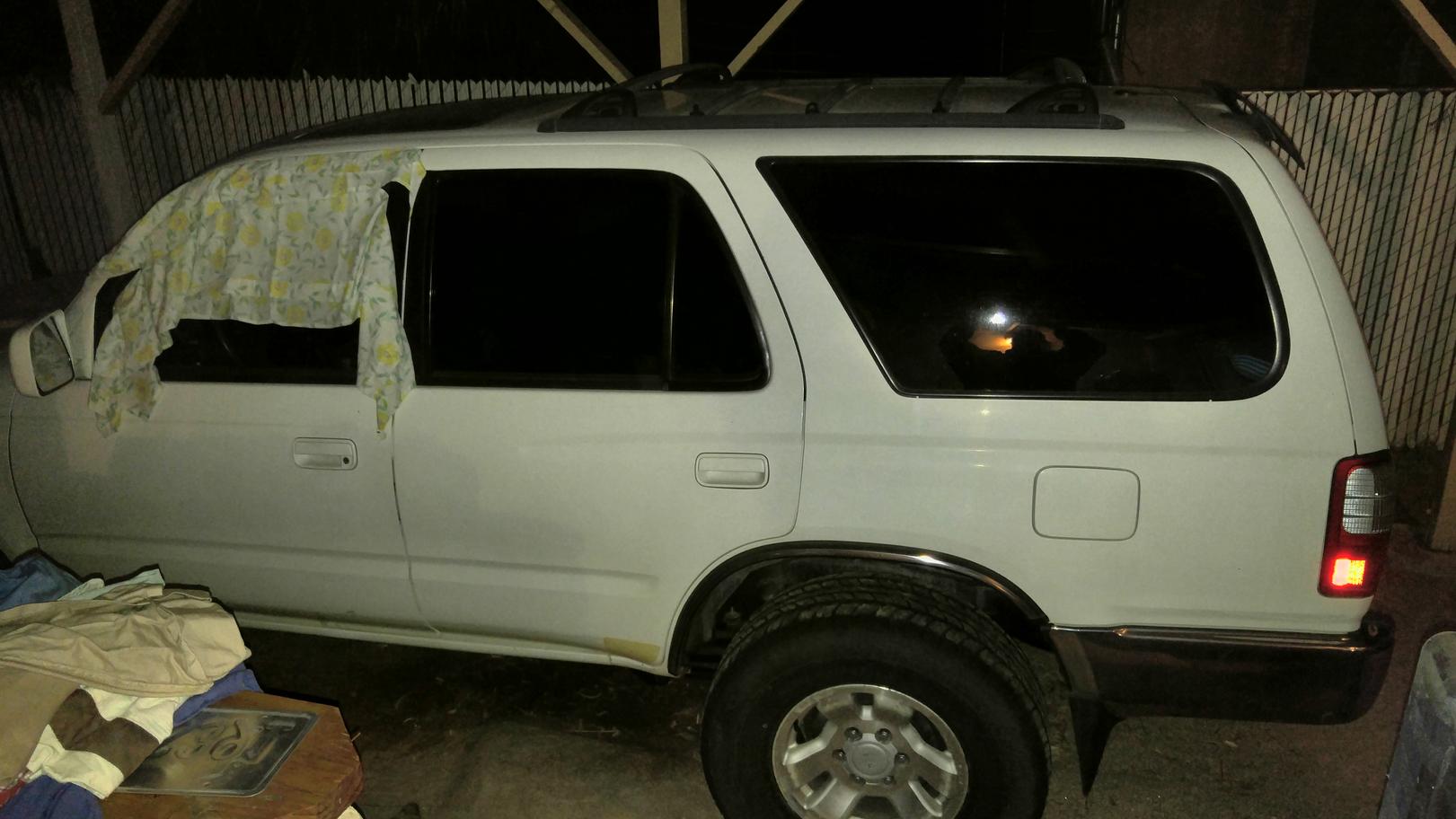

The wife kept seeing me occasionally look in the forum and at pictures of my old 98 and felt that now we are getting back on our feet maybe it was time to have a 4Runner again.
So she found a 99 for me that had a blown motor for very cheap and it is clean. Two days later found a JDM motor for $900 with only 30k miles, and a junk yard one with 170k miles for $800. I of course chose the JDM engine.
This will be a long process but at least I am back in a 4Runner, or will be soon. Here are the first couple pictures.

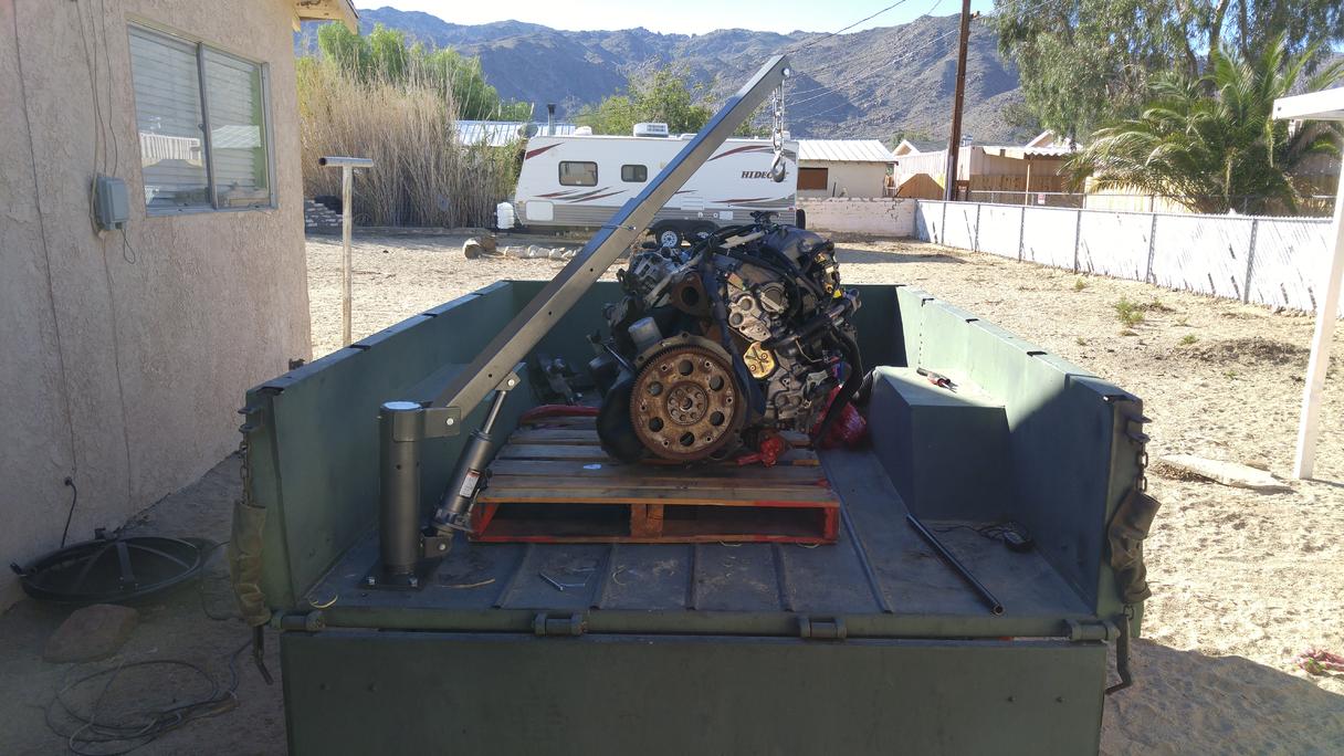

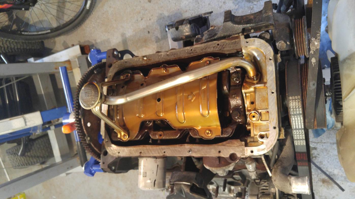

JDM Engine when it came home

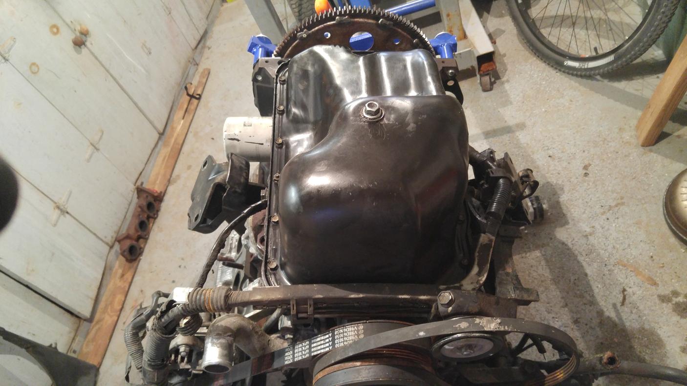

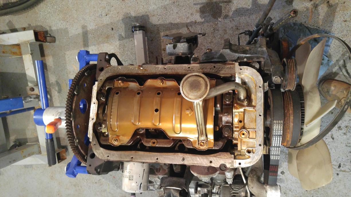

Have to swap Oil pick up tube and Oil Pan

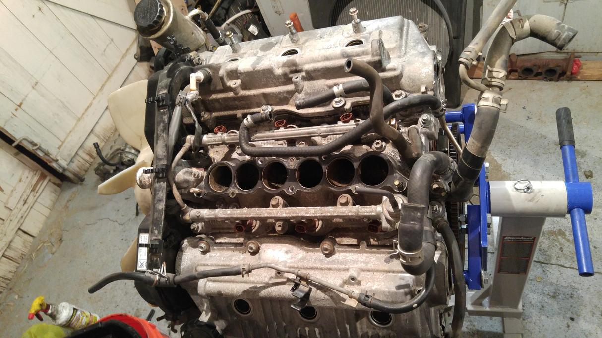

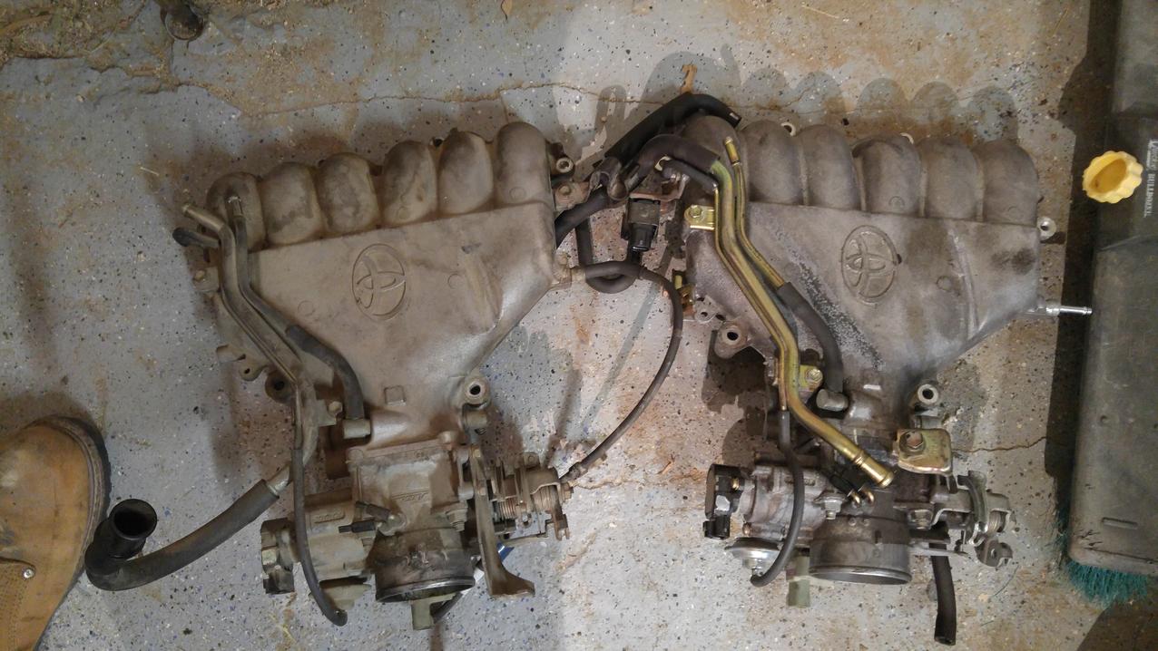

Engine ready to drop in. When they remove the engines in Japan they just cut the wire harness so you have to use the one in the truck. Also to remove the engine you have to undo the harness as well, so that is why the intake is off. There are also a couple of other things that need to be done to use the JDM engine such as transfer over your exhaust manifolds(or go to headers if they are in the budget) and your intake manifold if there are any differences. I will be using the JDM intake manifolds since it is just slight difference in routing of the vacuum tube brackets.

They cut the harness since it's useless anyway. Not OBD2. I used the original manifold to retain all the original vacuum house routing. Seemed easier IMO.
