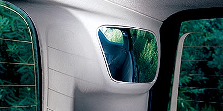

Can you supply a photo of said "mirrors in the cargo area"?
CargoAreaBacupMirror.jpg~original
87074-prestas-cb-install-liftgate-mount-3-firestick-pic-heavy.html~original
I think he is referring to these ?
I've never seen those. I've seen other auxiliary mirrors on SUVs and vans from the international market, but those are seen on the outside. The one in the picture makes a lot of sense.

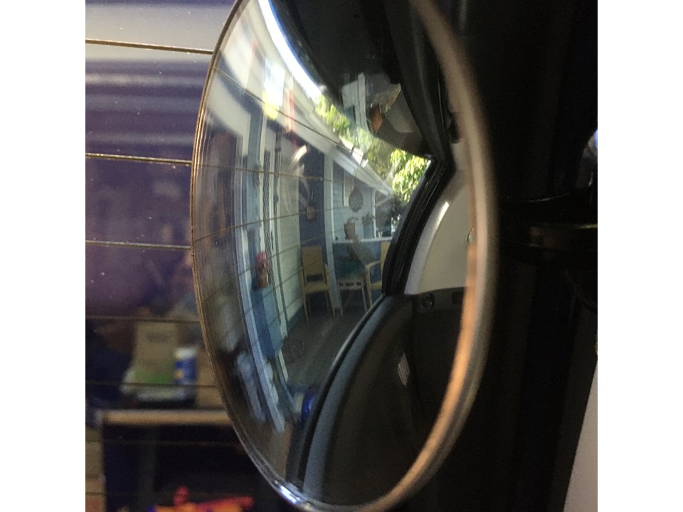

I also really grew to like those cargo area mirrors on my 2003 4Runner. Had it for 14 years and got a 2018 one, and immediately missed the mirrors, even with the new backup camera, which does not allow you to see down the lane in a parking lot when you're trying to back out of a stall. The cargo area mirrors did, allowing you to see both oncoming cars as well as pedestrians before you backed out.

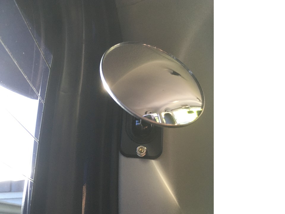

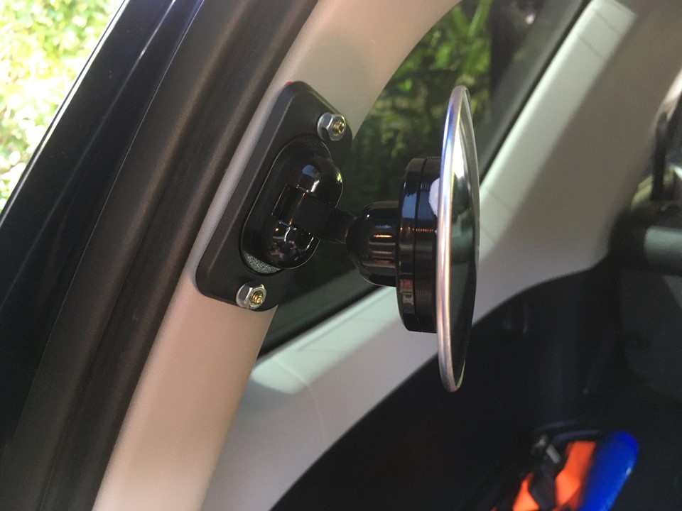

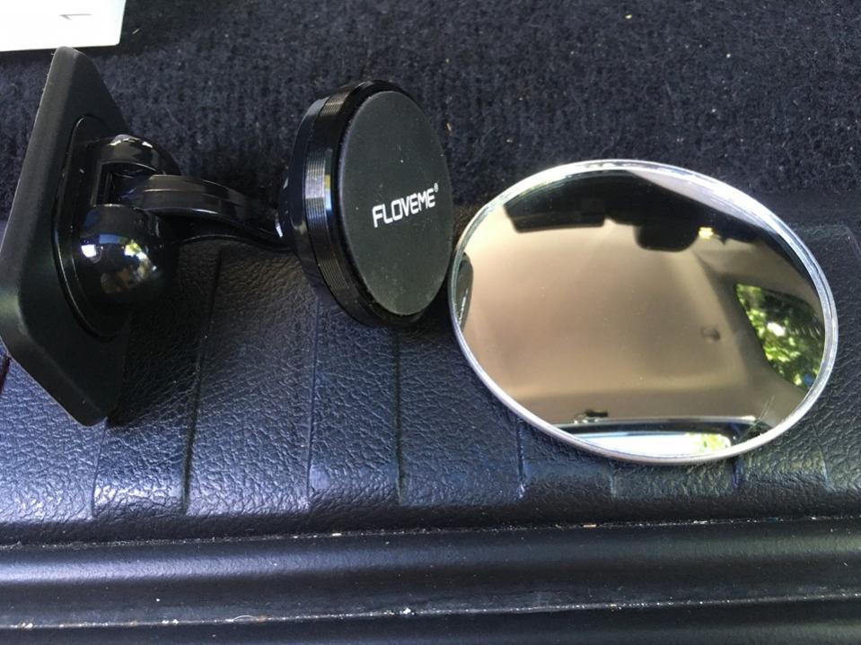

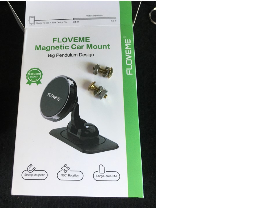

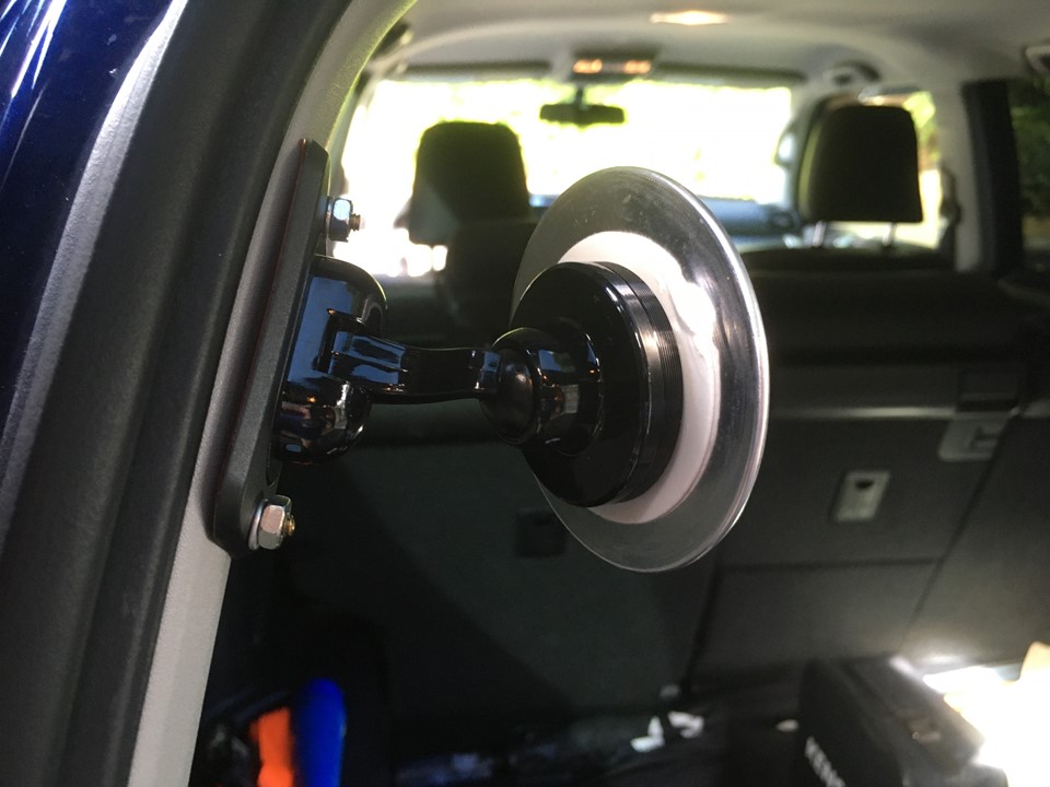

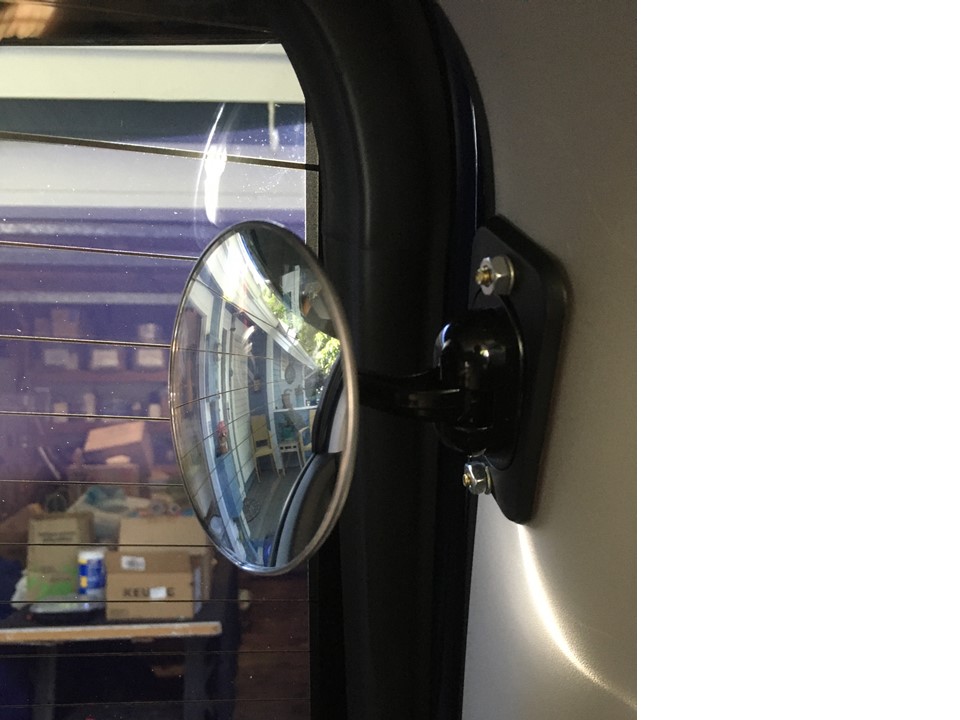

So for over two years I've been trying to figure out how to get similar mirrors back, and just worked it out. I bought these cell phone car mounting brackets that you can adjust to any angle, added standard 3" blind spot mirrors on the brackets, and ta daaaa! I can see down the lane again!

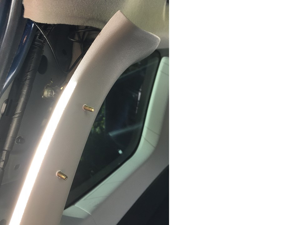

I decided to drill the trim back by the rear window for small bolts and split washers to hold the bracket on there - the surface is a bit curved and real slick so I didn't trust the double-stick tape. Tons of room by the rear window, too - the mirror is nowhere close to hitting the rear window. I pulled the 4Runner's trim off with a plastic trim pry bar (that came with my dash cam) and inserted the bolts from the inside of the trim to the outside so the end of the bolts wouldn't be rubbing on the wires in there. I.E. the bolts are facing out.
Hope that helps someone else who wants those mirrors back.
