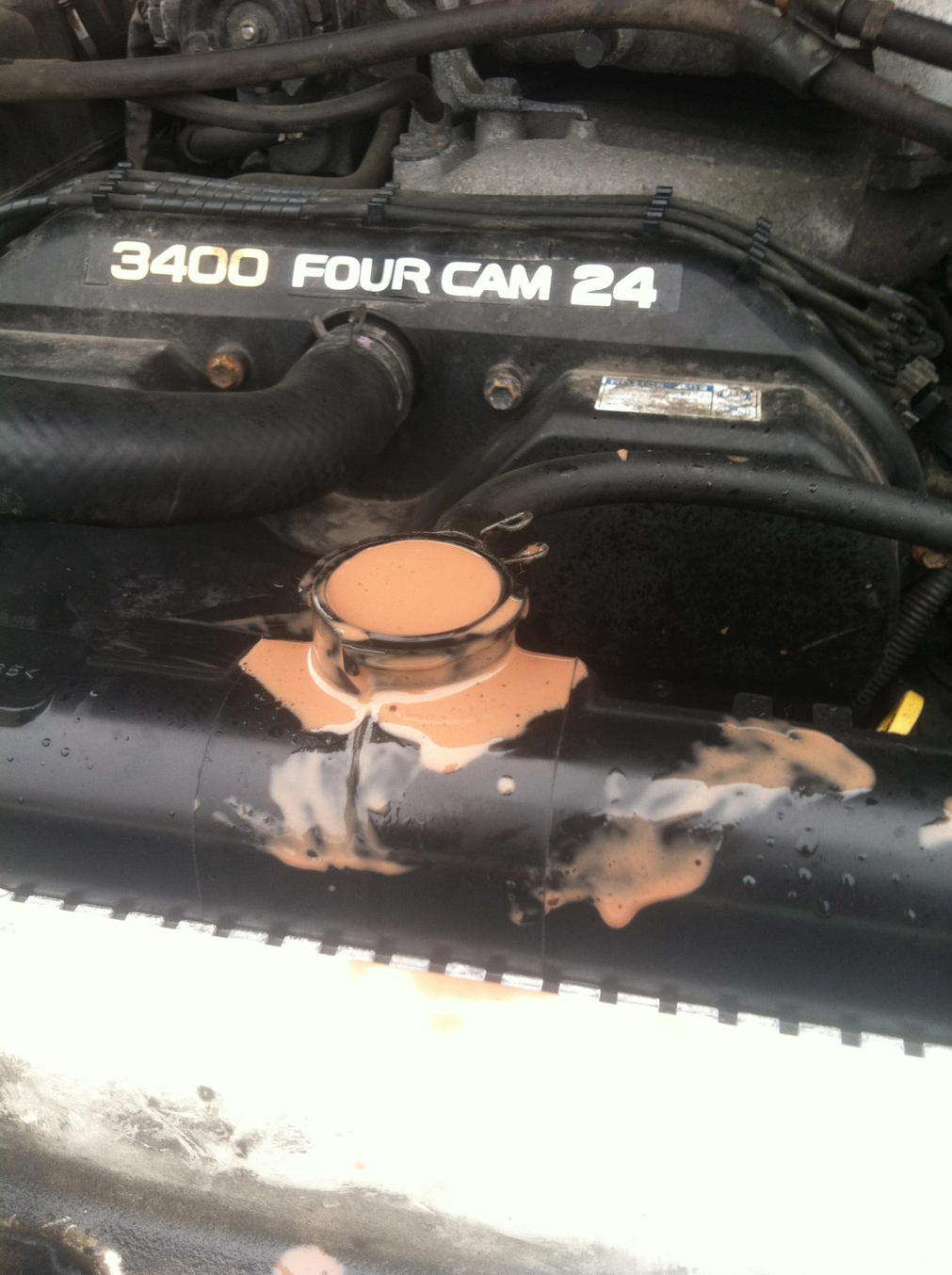

So I flushed the transmission. Washed out the engine lines with water where the coolant went in. I reinstalled the new radiator, attached the lines and added coolant. Took it for a ride and everything was great. Transmission feels smooth, engine was running normal temperature.
So I parked it again, and put it on a parking block to raise the front and proceeded to add the rest of the 2.5 gallons of coolant.
As I was adding the rest of the coolant into the radiator the picture shows what happened next. Pink milkshake rising to the top again????
Any ideas to what this could be? My guess was because I maybe not have flushed out the radiator lines good enough and left some oil? Thats the only way in my head that oil could have gotten into the coolant portion of radiator.
Any help would be great.. Could it be a bad radiator advanced auto parts gave me?? --->ToughOne or Ready-Rad Radiator Part No 431402
Ive already bought 3 gallons of orange anti-freeze and about 7 gallons of Dex 3 ATF. man.. I hope I can figure this out soon...

This "Washed out the engine lines with water where the coolant went in" doesn't sound like you flushed out the coolant system at all. You need to put water in and run it till it gets hot, opens the thermostat and allows it to circulate then drain. Do this over and over till it comes out clean. Run your heater too so the core gets cleaned.
kball,
Thanks for the info. When I did flush it last time I poured a lot of water into it while the car was running. I had a cup and kept filling and dumping water into the feed line and I watched a lot of milkshake come out the bottom.
Do you still think that I needed to pour more water into it? The thermostat had to be open if it was coming out the bottom. Maybe I need to do this again with more water?
As of right now, what should I do?

Not sure if I'm understanding you right but putting water into the top of the radiator and having it come out the bottom of the radiator is not flushing the coolant system. It's just flushing the radiator. The water needs to circulate through the whole engine, heater core and hoses etc... You can't take the radiator out and run the engine, don't try that. You need to leave everything hooked up. Fill with plain water, close the rad cap and run it until it gets up to normal temp. Run the heater and make sure you get nice hot air out so you know it's up to temp. Stop the engine and drain the rad by opening just the bottom petcock. Leave the cap on so it will suck everything out, even the reservoir will empty itself this way (you might want to remove the reservoir and clean it first separately). Then fill with water and do it all again, over and over until it comes out clean. It's going to be time consuming and a chore but it's the only way to get it all out. You need it to get hot so it loosens up the oil and circulates everywhere, through all the heater passages. If you have the rear heater you probably need to run it too so it circulates through that as well.
I poured water into the feed hose that ran into the engine from the radiator. I never rinsed out the old radiator from the original milkshake because the radiator was shot. The only flushing I did was pouring water into the big feed hose that ran into the engine and watching it come out.
Clearly I did not do this long enough. I will do this again, but this time for much longer and will also fill the radiator with lots of water as well. Also need to blast the front and rear heater to get everything circulated.

1. No, leave it all connected. Letting water run right out as you put new cold water in will not let it get hot enough to circulate.
2. Yes!
3. You will want to have the front slightly elevated to help burp the system but this is mainly for when you are done and trying to get it completely filled and all the air out. Right now you are going to be filling and draining, filling and draining so I wouldn't worry about that for now. Once it's clean and you are putting actual coolant in for the last time is when you want to get all the air out.
Great! I did not do this when I first had pink milkshake with my old radiator due to the ruined radiator. Never knew I had to flush the system with the new one hooked up! I thought I could just let it run out and fill with water.. Now this is making sense.
2 more questions.. lol.
1. How many minute intervals should I add water then drain it? Basically fill up radiator and coolant reservoir with est. 2.5 gallons total, then let the car run and let thermostat kick in. Run for 30 min? After this do I drain immediately? Or wait until it cools down? If I wait wont the oil settle? But if I do it too quickly will I get burnt?
1a. And you are saying drain it with just the petcock pulled off. So I should not remove the big return hose from engine to drain radiator?
2. And once this is all flushed out. When I am adding coolant with car elevated do I fill what I can into the actual radiator and then proceed to fill up coolant reservoir? Or do I just fill the radiator with coolant and that is all? And leave reservoir empty? I assumed reservoir was for coolant runoff...
1. How ever long it takes to get up to normal operating temp. You can let it idle for a while or drive it for a short time and it will warm up quickly. Just be careful when you drain it so you don't burn yourself. It shouldn't be burning hot at the bottom of the rad.
1a. yes just open the petcock on the bottom of the radiator. Leave the lower rad hose on there.
2. Fill the res as well. Up to the "F" full mark. Then check it after a few days to see if you need to top it off. It will probably suck a little more into the radiator since there's always a little air that doesn't get burped out until later.
Try pulling the thermostat out too. Leave the housing empty and put it back together. This removes the variable of needing the thermostat to open to get good circulation.
