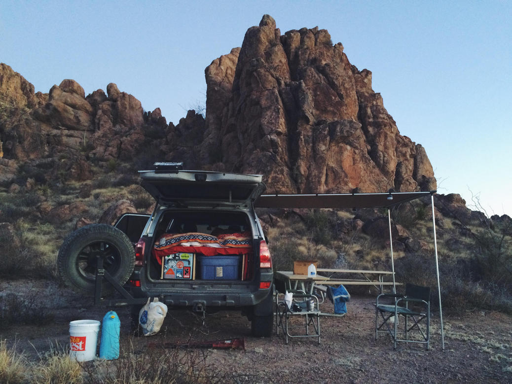

This is mine. Sleeping inside works great. It's pretty tight with two people and a dog though. I took mine on a month long trip before I had most of these mods. Having a platform that I can just fold out works way better than a tent.
The dual battery isnt expensive, and is worth the effort. I would recommend having redundancy for such a long trip. I found my fridge on craigslist for $150. It's been a huge improvement over the cheap coolers I used.
