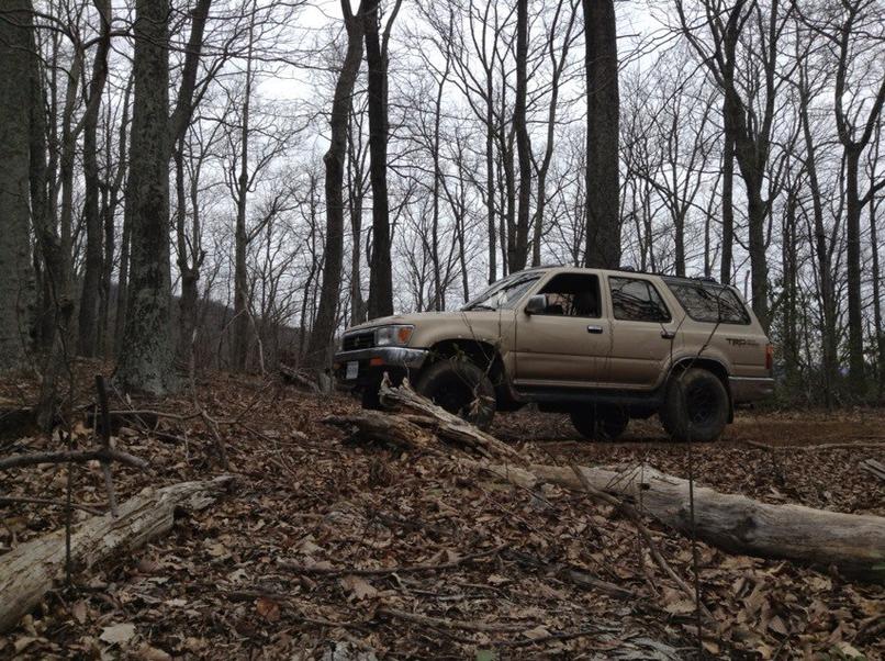

I am beginning to start doing some upgrades to my 95. I am weighing multiple options for a lift. I don't want anything more than, say 2 inches. I'd like to lift and still be able to run 31s without it looking like the tires are too small. I've thought about coil spring spacers in the back with ball joint spacers in the front and was wondering what you guys thought of that setup. I'm not very familiar with this stuff so anything helps.
I also want to add some rocksliders, a spare tire carrier, upgraded front bumper (Warn or ARB), maybe a roof rack and, some lights to mount on bith the rack and bumper.
This is it, I've since removed the running boards and added a nice sized dent to the left front fender (that's on my list as well).

There's lot of guys that run 31's on that setup. I personally prefer a filled out wheel well, and went with a 285/75/16. It seems like you have a good plan. There a lot of front bumper fabricators out there popping up with designs for these rigs, much cheaper alternatives than those two plated bumpers. 4x innovations makes a popular slider on the cheap, with great quality and options.
Will the spacers actually give me two inches of lift or will the springs compress with these added? Everyone says these can get rid of the sag but mine doesn't sag at all. I want people to look at it and wonder if its lifted, I like that look where it is lifted but just looks a little beefier than stock not too high.
