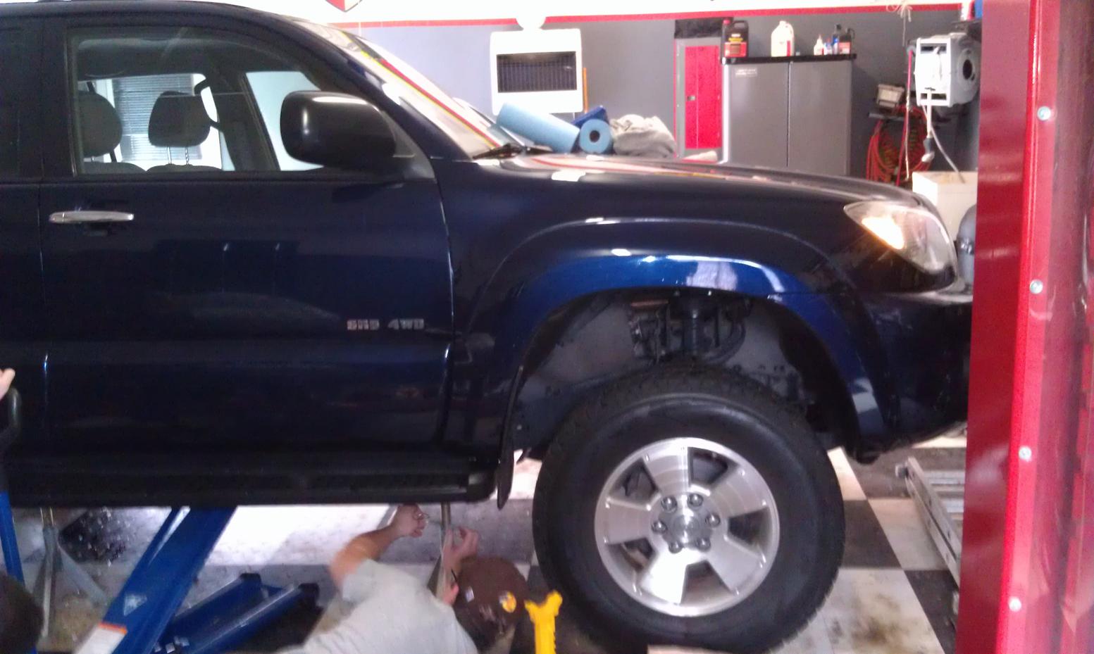

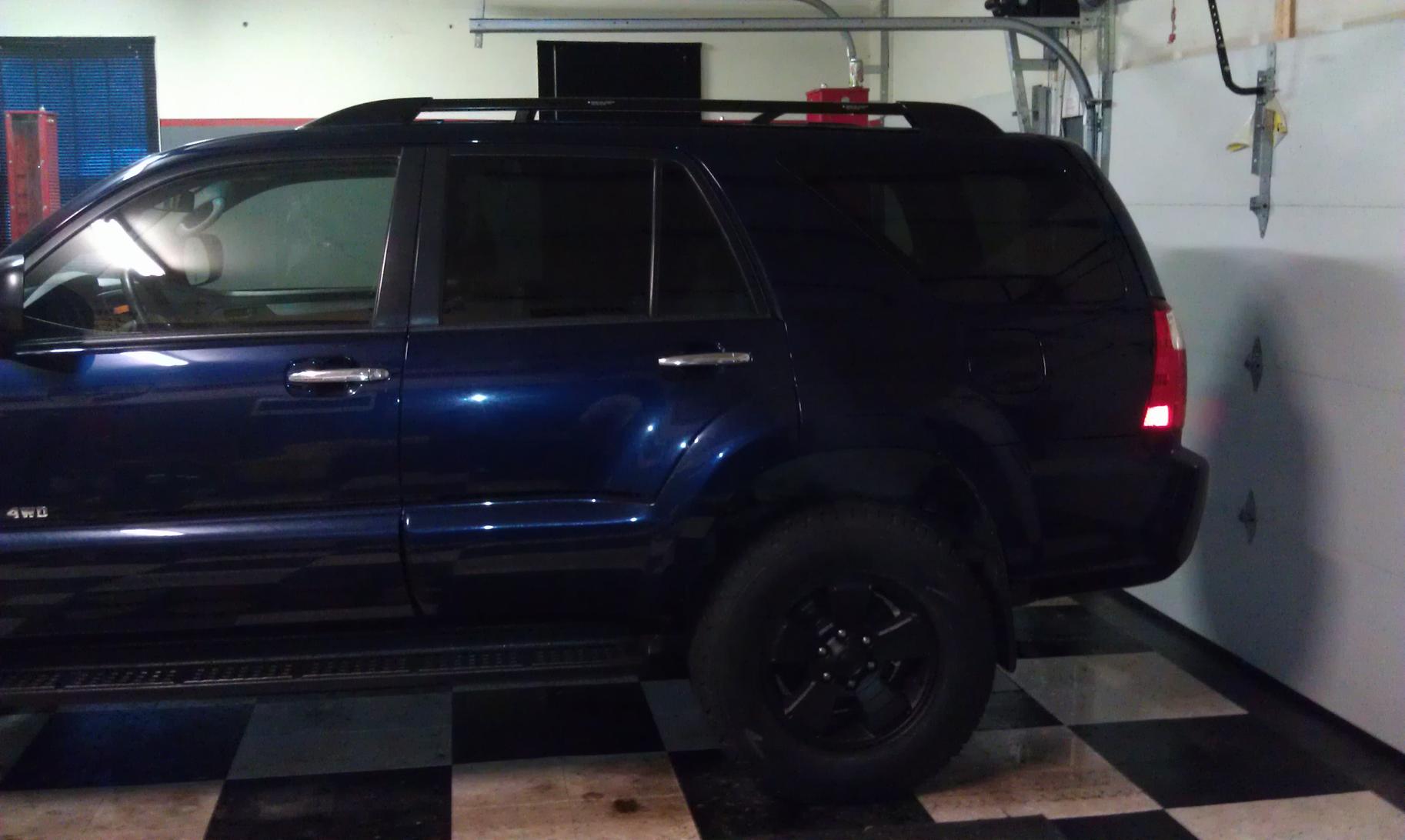

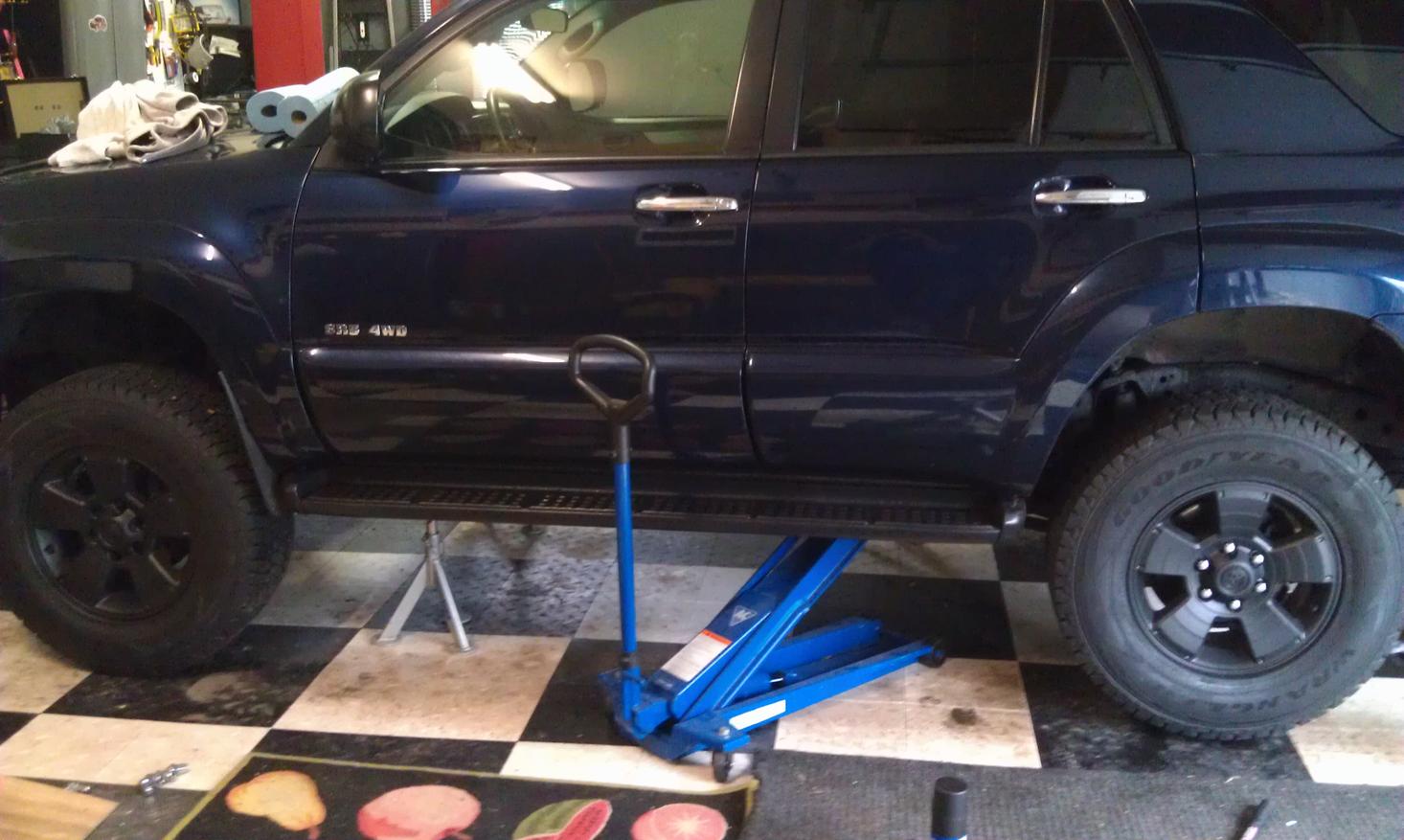

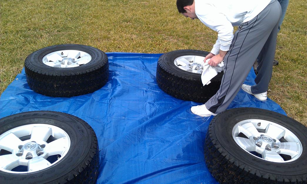

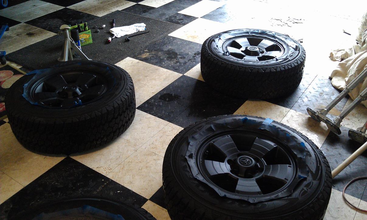

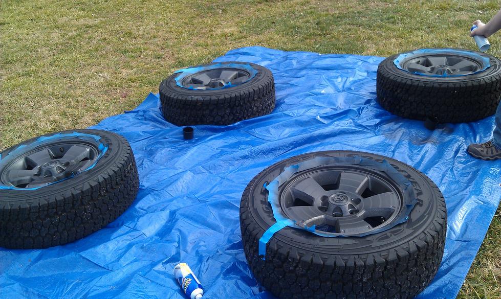

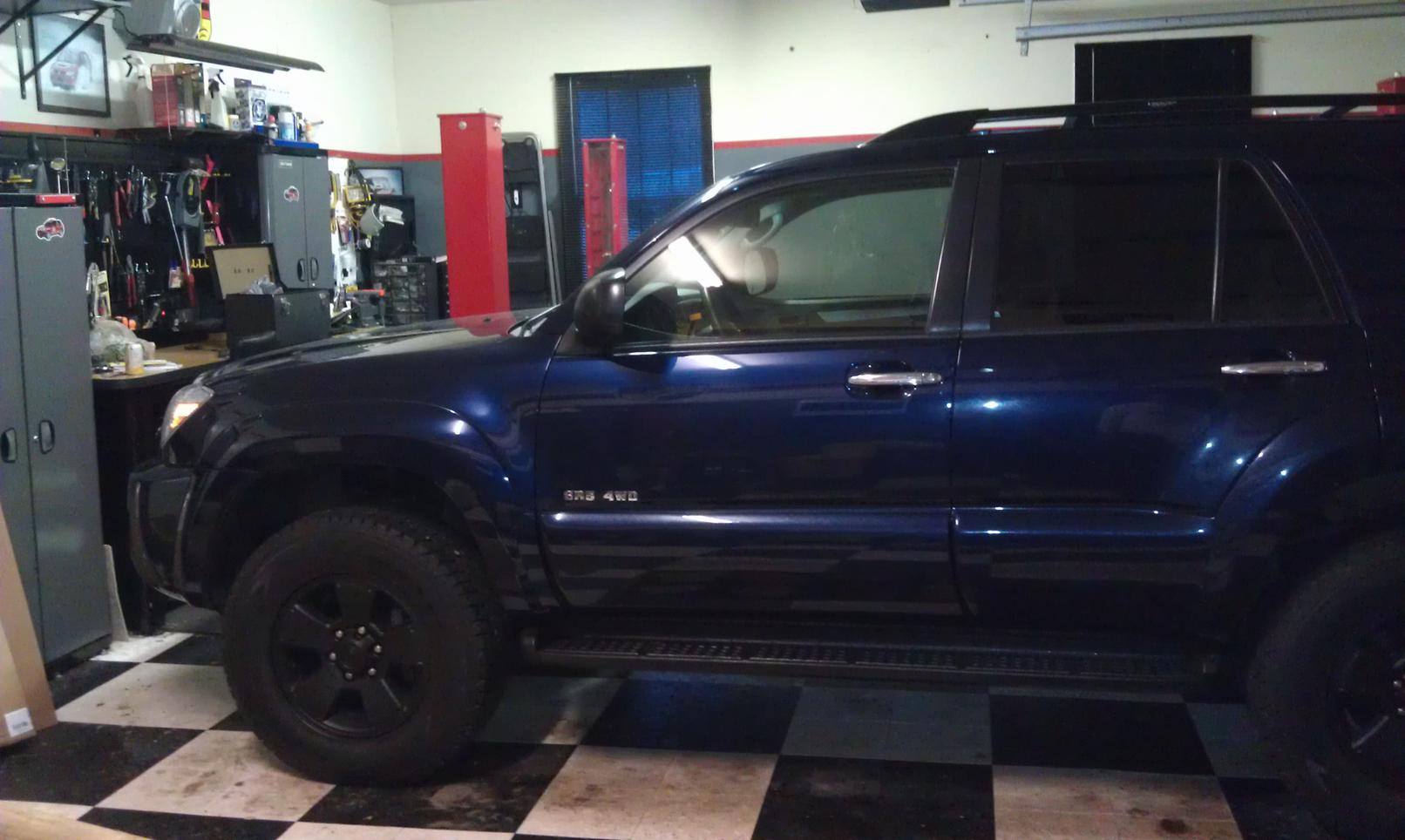

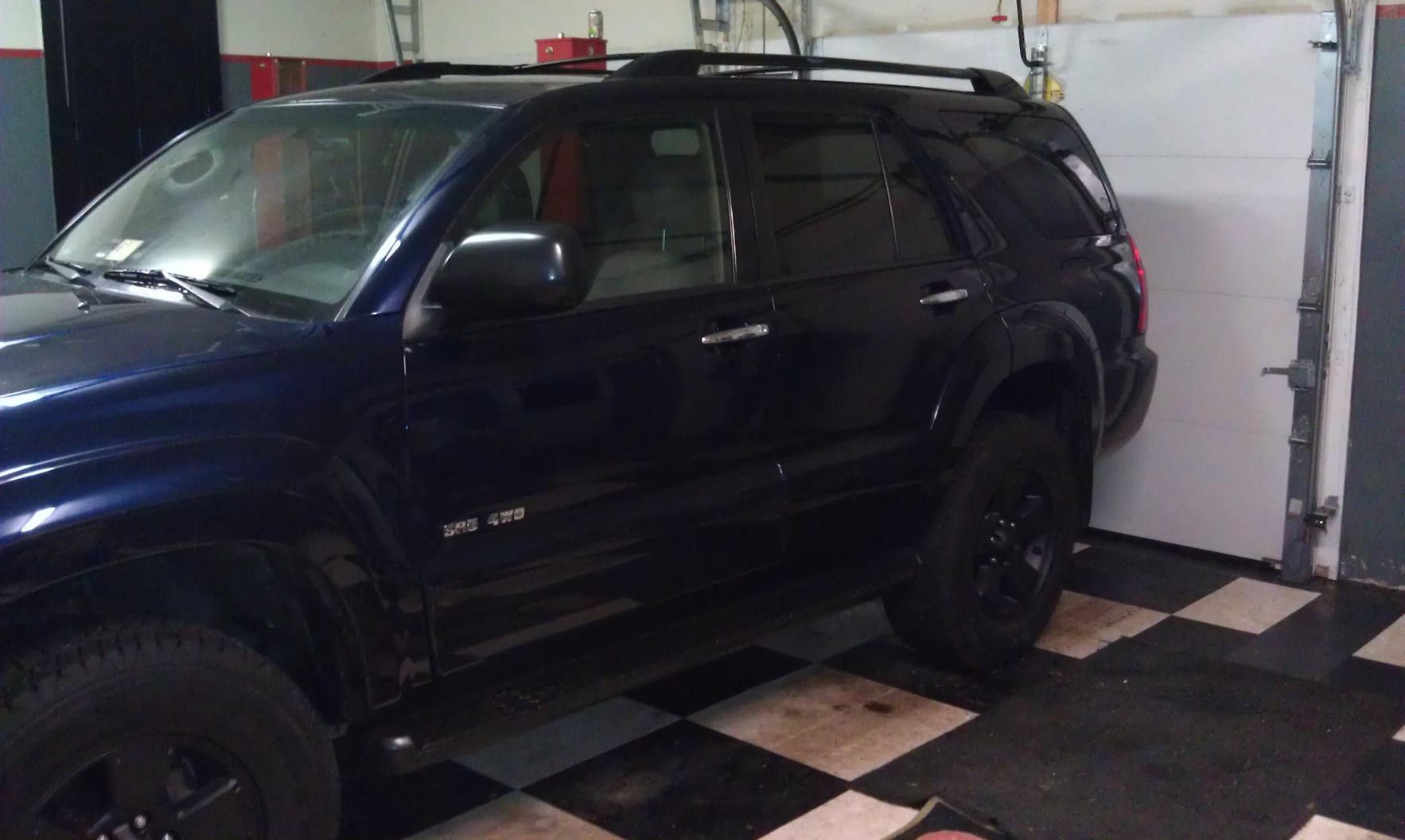

here are some pics, finally plastidipped my wheels this weekend. removed the front mud flaps. soon removing the side-steps. i plastidipped the side and rear badges, will update with some pics. loving it so far.
not the best cell phone pics, but figured it's good for now.

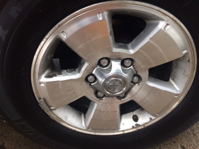

I'm wanting to dip my wheels soon. The current coating is peeling/bubbling. Just want to make sure I do this right. Should I do anything else besides sand, wash/dry prior to dipping?

Would love to see how they turn out - mine are in rough shape as well, and I have the same wheels.
