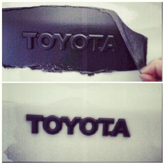

I wouldn't take any of the emblems off, except for the front one just because it pops off from the backside of the grill. When you tape a square around the emblems, be sure to give yourself about an inch or so in order to give yourself a tab to work with when peeling the excess.Don't tape right up next to the badge because when you go to remove the tape, it will peel off the plasti-dip with it. Then use a toothpick to remove the dip inside the letters. Also, make sure you spray all the way onto the tape so it will peel off easily and not speckle. If you-re doing your grill, I wouldn't recommend taking it off because you can easily break the latch, and its just easier to do it with the grill on. The youtube page is extremely helpful for tips. I've done all the chrome on mine so far.

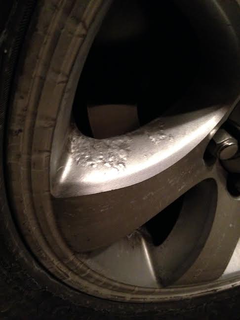

New to posting to this site. Anyone have defects (bubbling under the paint on their wheels) before dipping? It seems the previous owner didn't take great care of them and there are a handful of spots like this on the set. FYI, probably looks worse than it is due to the dirt/salt currently on them. Just wondering how it might turn out. Thinking about dipping my wheels but was wondering if the coating covers up defects at all or if it make them more pronounced. Also, anyone done the gunmetal grey on a Shadow Mica 4Runner? Was thinking of try that out. I've got the 6 spoke wheels on a 2006 sport.
I know the sr5 rims on my 04 were repaired by a dealership from the previous owner's request. I dont know that there was a recall for paint bubbling/peeling, but it seemed like many had issues with it happening. Again, this was the sr5 rims, not sure about sport rims but it could be the same.
I still haven't done mine yet. I hesitated on doing the rims. Not sure I like the blacked out look as far as rims go on a stock T4R. But, the rest of the chrome is as good as plasti-dipped come spring.
