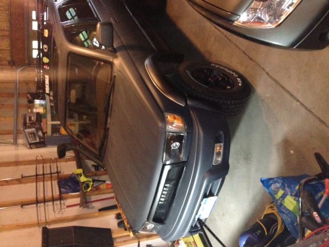

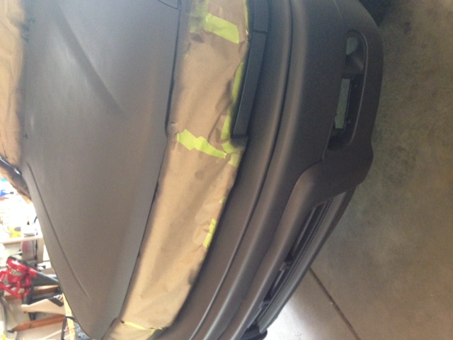

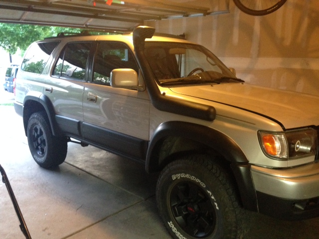

So, I had done the fender flares and rocker panels last September in black. They have done fantastic with almost zero fade and no (that's right) peeling. Multiple pressure washes and too many to count auto washes with no issues. I read a lot of posts from haters. I think the step that all have been missing, remove the wax so the plasti-dip has something to hold on to. Pics are below, before, during, and after. If I had to do over, I would skip the matte clear. The clear spray left a "sticky" to the touch feeling. Otherwise, I like it. What do you guys think?

Looks rad, I'm more than impressed that it holds up to pressure washing. What exactly did you do to remove the wax? Clay bar?
i really want to see more pictures at different angles.
did you just use rattle cans? how many cans? did you get any zebra stripes?...
I'll get you some later today. No zebra safari stripes. Zebras aren't native to Colorado lol. I used a spray gun, it would have equated 10-11 cans.

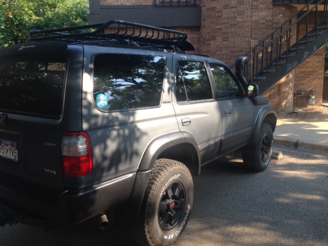

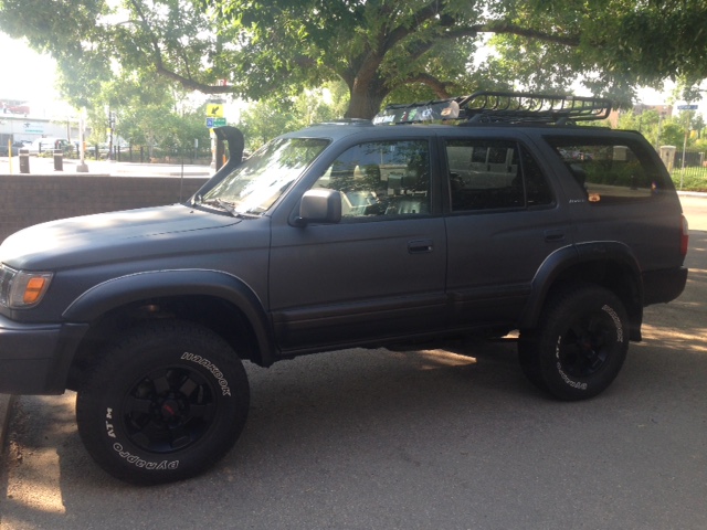

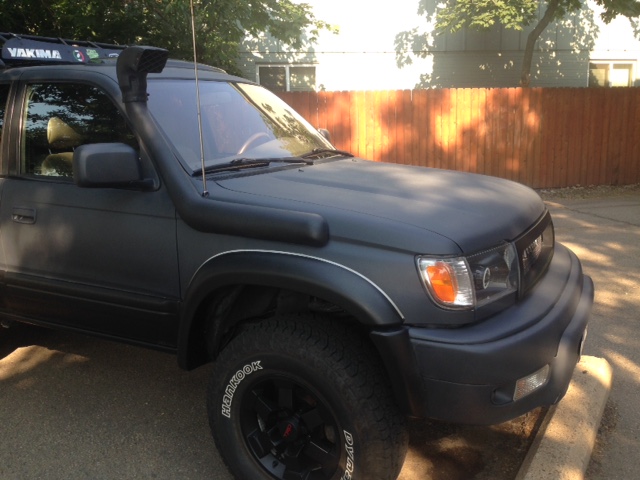

Sun, shade, and other.
