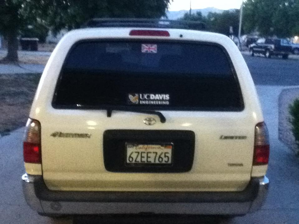

J Jbot New member Jul 30, 2013 #1 Is there a way to remove the plastic bumper trim. Im going to paint it, but i really dont want to mask up the whole back of the runner to do it. If so how, thanks! pic below for reference Attachments plasti 4.jpg 83.2 KB · Views: 1,300
Bad Obsession New member Jul 30, 2013 #2 1. grab firmly 2. pry upwards It just snaps in there. Give it a good tug....it'll come off. You can try gently prying with a screwdriver also.
LittleCaesar New member Jul 30, 2013 #3 There are 4 or 5 tabs that you can pry out with a long flat head screwdriver, except for the one under the tow hitch. Should take ya no time.
