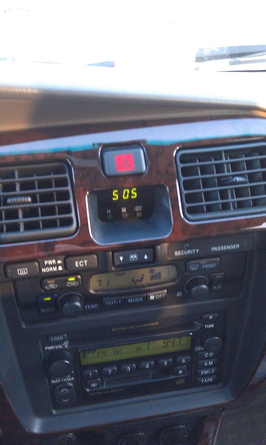

How can I remove the plastic "wood grain" above the radio and around the AC vents? I want to install a Garmin Nuvi ball for my GPS ....
Start down at the cup holders. Should be a screw on each side. If your 4x4 there is one screw on that shifter. Then it all just pops right out. There are quick disconnects at each electronic device. It's pretty simple.
You can see pictures on my build thread of that would help you. I also found several videos of people taking the dash out on YouTube
