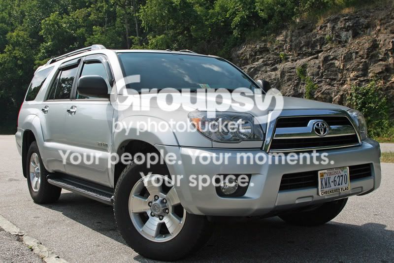

Thinking about taking the plunge and Plastidip'ing the wheels on my '06. Question for you guys with experience, how much did you need to do a nice, even coating on all four wheels? My wheels are 17in. Thinking about anthracite, gunmetal grey, or black.
Thoughts? Suggestions? Tips?

Thanks for the updates guys. Most sites seem to be dedicated to folks doing this for the temporary "look" on their cars. For me, I want to slow down the horrible chipping/flaking the Florida salt has caused my rims (and for looks).
What's the best pre-dip strategy for those chipped and peeling rims? I plan to pull the wheels off the truck of course but I'd rather leave the tires mounted. I'm in the process of getting new tires so the plan is to have them mounted then do all the prep and dipping. Yes, I don't expect to ever peel this and go back to the standard finish so a bit of sanding and wire-brush work is to be expected.
Years ago I had a similar idea to repaint a set of wheels on an old Honda. I didn't realize at the time that the face was machined then clear coated while the inside of the spokes were actually painted. They turned out horribly.... I'd rather not repeat that. I know the dip isn't going to fill in the edges of the chipped areas perfectly (without spraying a dozen coats) but I'd like to camouflage them as much as practical.
