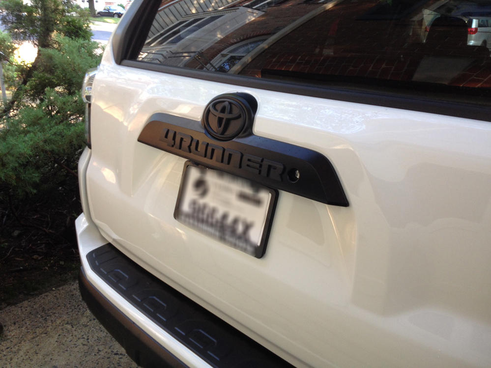

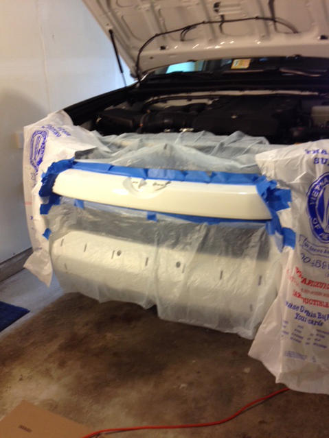

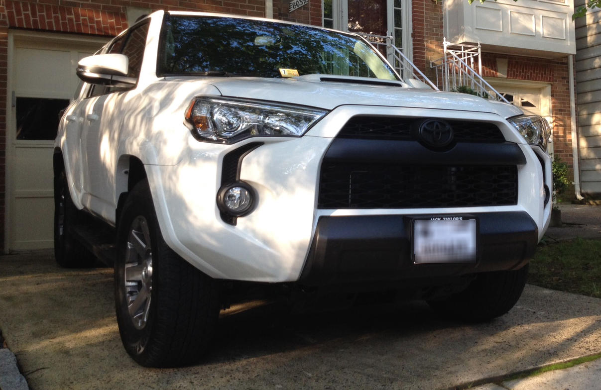

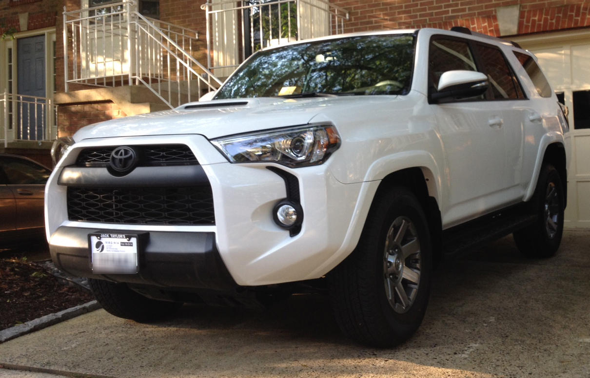

Hi Guys,
Waited for my White TE for 3 weeks after I ordered it and played with Plasti Dip over the weekend. I am happy how it turns out even though I didn't have a prefect job done. It's my first time with the Plasti Dip and I am really impressed for this product. Enjoy!

DIG IT!! Did the same with mine a few months ago. Really think it completes the look of the front end. Nice job

That looks awesome! :thumb3:

Did you remove the rear trim piece on the tailgate, or just tape it off like you did the front?
I think it makes it look like a storm trooper helmet. I really like Star Wars, so I am trying to figure out if it's a good thing or not.
Thanks guy. The process is really easy except to remove the front bumper piece. There is 13 clips inside the bumper in order to remove it. I would just tape and paint it if I need to do it again. That's what I do for the rear bumper piece, much much easier. There is no sanding needed and so much easy to remove, just make sure you have 3 or more layers applied.
The top grill is really easy to remove. Just two 10mm screw and one plastic nut holding it. After removed screw and nut, you can just pull it away the bumper by standing in front of the car. The tricky part to to define the edge of the line to put the tape and you need to apply a thick layer of plasti dip and remove the tape before it's dry. See the vids below for details.
Bumper and emblem
https://www.youtube.com/watch?v=otCtkVePX_0
Center bar method
https://www.youtube.com/watch?v=2kBWaSDmj0g
