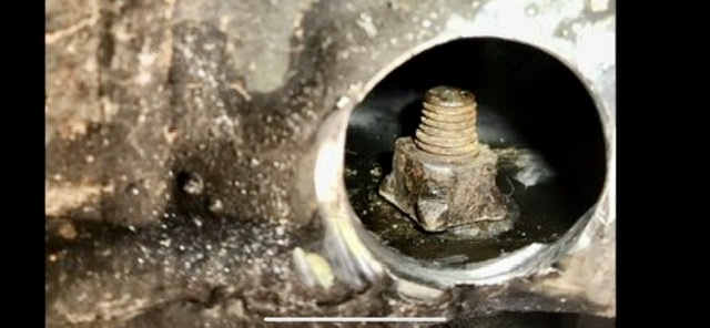

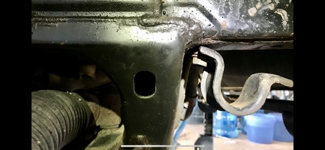

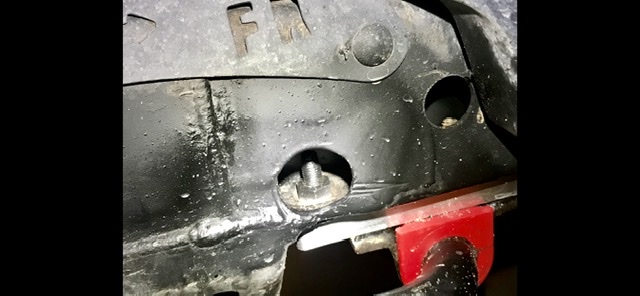

Not sure if the same thing happened to yours as mine? My weld nut inside my frame broke the welds and acted like it was stripped. I couldn’t get the bolt out more than halfway.
Had to drill my frame out, get the open end of the wrench on it, and just replaced the nut. Planned on welding it back to the frame and plugging the hole but haven’t bothered.
Similar actually, except I stripped the threads. I was on borrowed time. A few years ago, I knew I stripped the thread and have been getting away with carefully rethreading the weld nut.
I ended up breaking off the weld nut using a tapered pry bar. This video was helpful:https://www.youtube.com/watch?t=210&v=AG3N_0xEwok&feature=youtu.be
The stock bolt is a m10, but I only had m8 rivnuts on hand so put one of those in. Put in stronger grade 10 hardware and called it a wash-- I'm pretty certain Toyota uses grade 8 hardware.
