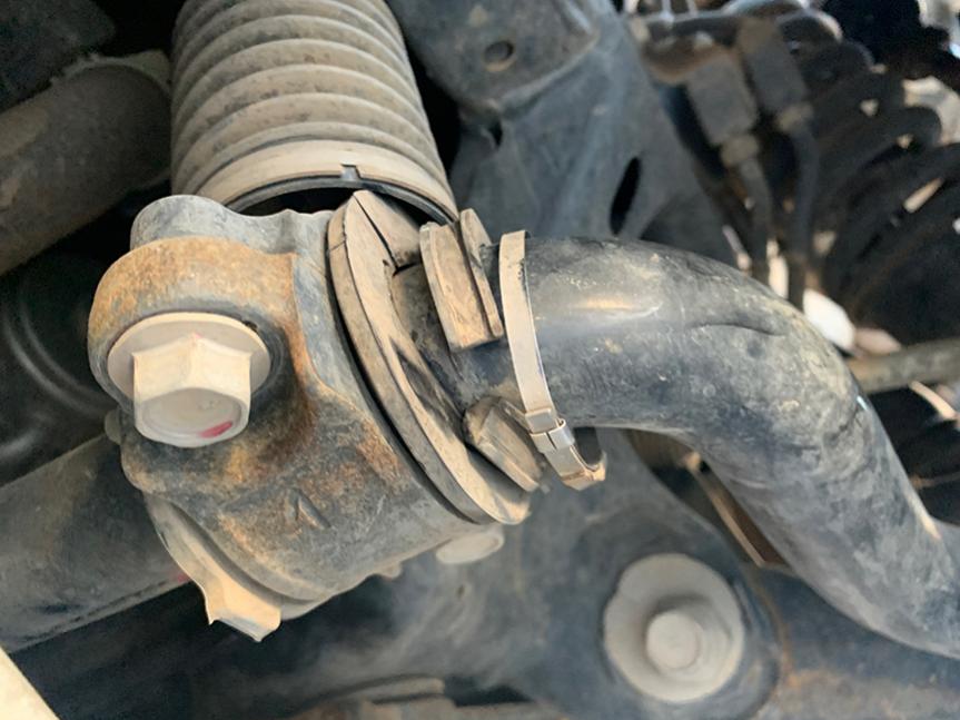

Within 2000 miles of buying my 2018 I noticed the metal band clamp was off the driver's side KDSS sway bar bushing. It's there to help keep the bushing from extruding and I asked the dealer to replace it. They replaced the whole sway bar.
Shortly after that I added a 2.5" Radflo lift and E-rated KO2s. A few times a year since I've exercise the truck fairly vigorously.
At my 35K service I noticed that same band clamp off again, I then noticed the bushing had extruded and split radially. They replaced the whole sway bar again.
In both cases the dealer said they can't get the bushing alone, just the whole sway bar assembly. Since it looks like I'm going to need to replace that driver's side bushing every 15K-30K where are people getting the loose bushing from?

thats odd...you talking about this thing?
Toyota 4Runner Suspension Stabilizer Bar Bushing (Left, Right, Front) - 4881560390 | Toyota, El Cajon CA
I also had issues with the metal clamp and just cut it off and used a zip tie. Worked pretty darn well!

I had the same issue with the fastener coming off. Dealership wanted to replace the entire sway bar. I just added a zip tie and has been holding on for months now. I'll just keep replacing
Zip ties come off within weeks. I have a 2.5" lift so maybe that's causing too much distortion for the bushing to stay in place, or maybe I'm articulating the suspension more than others.

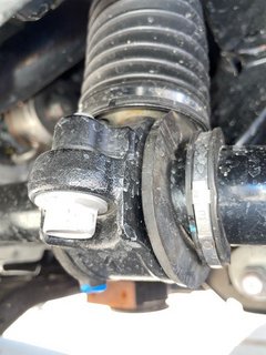

Resurrecting this thread - trying to diagnose a rattle in the front left of my (2021 ORP w/ KDSS, 5k miles) and I just now found the *exact* same problem driver side bushing has split off in two, like the photo on page one.
Now my question is - I'm afraid to let the dealership even change the oil in my car, so should I just buy the bushing myself? Do these require any special lubricant or ?
Thanks DougR - do you or does anyone know what the factory spec torque is for for these bolts? Going to try and replace the bushing soon.
*photo of my driver side:
Did you end up replacing the bushing yourself? Got the part number for the bushing? The posting link on page two doesn't have the metal clamping on it so I'm not sure it's the same part.
