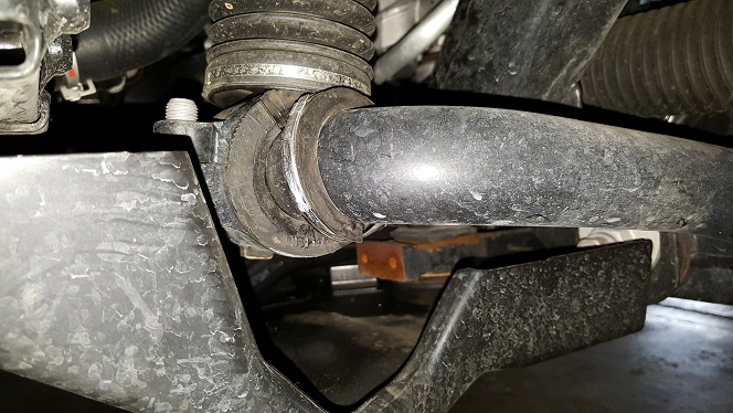

So my front sway bar was replaced under warranty because of one of the bushings under the KDSS cylinder getting loose and separating. I took my truck in to point out the issue back in December. And here we are now that it is February. It took a whole bunch of calls and messages from me to get this repair rolling. But long story short this is the outcome.

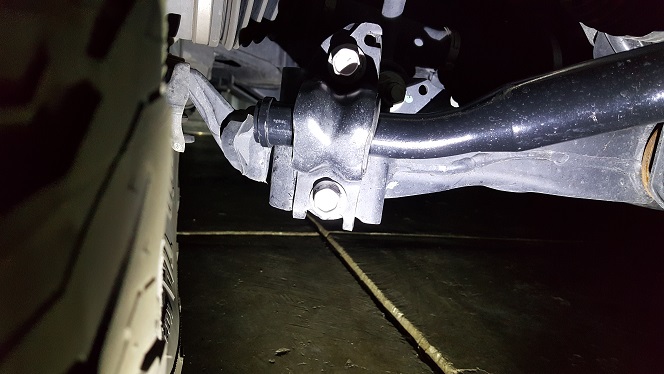

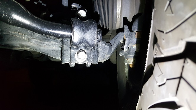

Now after they replaced the whole sway bar. Bushings look good. But I noticed the end of the bar on the passenger side comes out farther from the bracket compared to the driver side. The driver side is a lot shorter. I'm just wondering if this should be something to be concerned about. I imagine on road driving doesn't move the sway bar too much. But what concerns me is off road driving once the suspension and sway bar starts moving and articulating a lot more. Any thoughts, or am I overthinking it and worrying too much?

That bushing is $8. I've replaced mine proactively, as well as the bushing on the fixed side, and the bushings where they mount to the LCAs.
I can't fathom why they would replace the entire swaybar.
I think you might be surprised how much the swaybar moves around in all directions. That gap may very well appear on the other side at some point.
No worries. As mentioned above, if it's quiet, no problem.
Thanks for the replies. It puts my mind at ease now. I was also wondering why they had to replace the whole bar and I told them just to replace that bushing. But they insisted that the bushing and the whole sway bar had to be replaced. Which kinda ticked me off since I was without my truck for 4 days. Oh well. Its fixed and hopefully no issues. Now I can finally put my Kings on!
