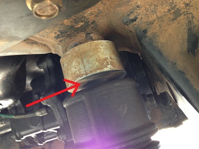

As ridiculous as it may seem, all this noise (and months of headache) was due to the differential stoppers (Toyota's name for the rubberized washers) not being re-installed between the differential mounts and the chassis.
Below is a picture of my truck with the stopper/washer missing and another picture of what they look like installed. Without them, the differential mounts would slam into the aluminum differential drop spacers when the front wheels were under load.
