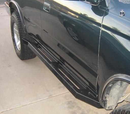

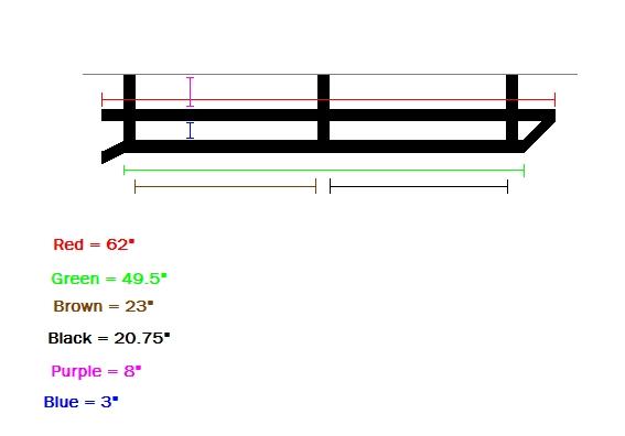

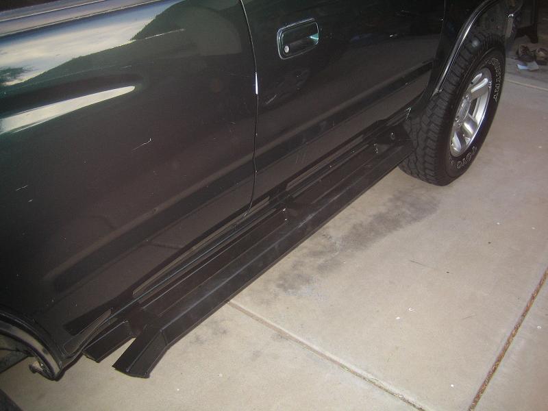

Thanks. It Is A Sport, the guy who owned it before me dented the front bumpper and replaced it wit crome, so I bough a after market rear and put it on. I still have the painted rear stored in case I want to change to all painted. I also still have the Running boards..just in case, But I weld as one of My WAY to many hobbies. A guy on the site had some Custom Rock sliders made and I fell in love with them. He was nice enough to draw a diagram with all the sizes and sent them to me. They are made of 3/16 x 2 in. square stock. I should start shooting sparks from my welder soon. I have all the stuff, just not the time. If you would like to see them, let me know and I will post photos of them along with plans for them, that goes for ANYONE who wants to see them. You Guy's and Ladies on this site are #1 in My book.
that would be awesome! if you do get around to fabbing some up, post up some pics, i may just pay you to make me some too haha
