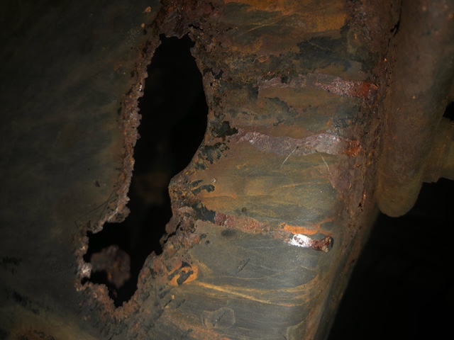

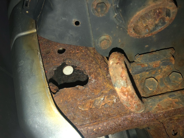

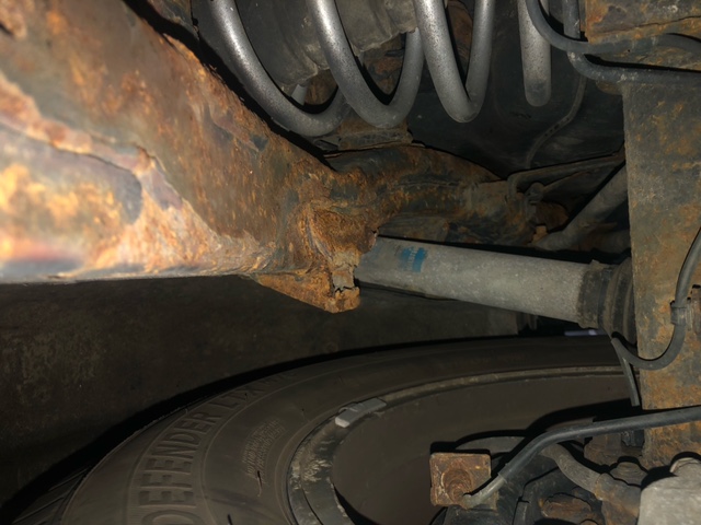

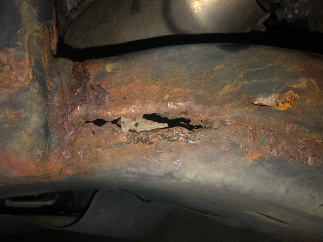

11/13 Update**
Some pretty bad news. Went digging around this afternoon to see what I could find in the way of more holes, etc. It’s really bad.
I found 4-5 more holes, massive corrosion. It’s now obvious the used car dealer in Ohio that sold me the truck three years ago covered a bunch of stuff up with bonding and coating.
The rear where the bumper covers the frame, and the entire metal piece that holds the rear bumpstop on the drivers side has rusted out of the vehicle.
The problem seems invasive, and terminal.
I’m super bummed. Just totally crushed by this.
One of the holes I found is right along the weld underneath the frame as in arches up to the front passenger side. She seems unsafe to drive at the moment.
I feel that welding is just putting a bandaid on flesh wounds EVERYWHERE.
I feel as if a new frame is the only option.
Has anyone, I mean anyone done the frame swap or know of a shop that can do this in the mid-Atlantic??
Who feels she’s unsafe? Will Toyota help? This is BS

I don't think it's unsafe at this moment for on road use as long as all your spots where suspension component brackets are welded to frame are solid. Such as all the rear bars, shock mounts, front crossmember where LCA attaches, etc.
Yes, a frame replacement would be ideal, but it's probably a long shot, or will be big $$$ if you can find someone willing to tackle it.
Google 4Runner frame replacement on youtube and you'll find some videos.

Thanks. It's kind of the front A-arm hole along the weld that freaks me out. And has anyone ever had the entire rear bump stop bracket come out?! It literally was hanging so I just tore it off. Do I not need that, lol? Saw a couple videos. Really extensive but you dont think someone would do it for like $5-6K?

What do you think of the bump stop mount rusting out? It's completely gone now. Do I technically need it? I guess I could have another one welded in?
Not sure how important rear bump stop is on road vehicle, someone else can comment on that. But something you might want to consider is looking at some of the "For Sale" V8, 4th gens on here that are for sale. There is an '06 or '08 on here for $9K with less than 200K miles and if it has a solid undercarriage might be worth considering and then part yours out. Just a thought.
