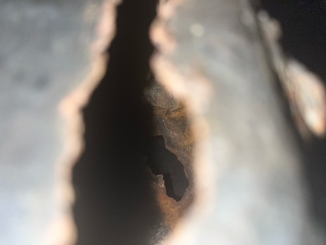

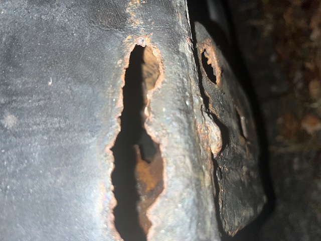

So, here's my new hole. It's an interesting hole. Because this hole is double sided. It is located inline with the front cross-member that is directly under the front doors. The hole is on the outside of the passenger side frame (where the door is) and there is an inner hole that can only be viewed through the outside hole. This is because the inner hole is directly inside the cavity of the cross member, so the cross member metal is still good but the space that occupies the inside of the cross member, on the inner frame has a hole. If that makes sense.
Yes, a mouthful and hard describe, but take a look. My welder from last year hasn't responded about fixing my new hole. Im worried that the inner hole would be hard to address given its location and proximity to the cross member. My guess is to cut the outer hole fairly large as to fit tools inside the frame to address cutting out the inner hole, without compromising the integrity of the cross member.
Very confusing to me but I'm sure a professional welder sees a path to victory, hopefully.

Any opinions Rdruss on the inner hole? Do you think this is common and does it complicate matters? Thanks

Any body have this exact pair of holes? Little concerned its proximity to the cross member. But others with large holes have commented in the past that my holes are small and to stop spazzing out. They may be right.

What I quoted above is what I would do. That outer hole is going to end up pretty large once the rust is all cut out. Hopefully the other side is not as big and a plate can be welded on the inside before the outer plate is welded on.

Got under again today. That hole has a top, bottom, and inside parts of the frame rail. And it’s all around that cross member so I have no idea how they would patch that because that cross member is welding right there.
