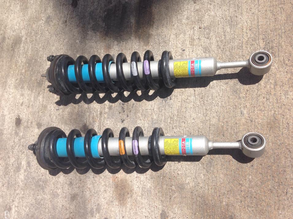

grantprior13 New member Apr 1, 2015 #1 I'm installing 2010 Fj springs on my 2003 4Runner and not sure which is the driver side? Please help? Also is it just the front springs that are different or are both front and backs different sizes for different sides? Thanks.. Attachments image.jpg 138 KB · Views: 247 Last edited: Apr 1, 2015

T themuffinman619 New member Apr 1, 2015 #2 I'm pretty sure the gray and purple is passenger. Someone correct me if I'm wrong.
X X6RUNNER New member Apr 1, 2015 #3 themuffinman619 said: I'm pretty sure the gray and purple is passenger. Someone correct me if I'm wrong. Click to expand... Sorry! You're wrong. Grey and purple (or more coils) is on driver side.

grantprior13 New member Apr 2, 2015 #4 X6RUNNER said: Sorry! You're wrong. Grey and purple (or more coils) is on driver side. Click to expand... Thanks... was trying to go through a ton of threads but figured i might as well ask..:bounce:
