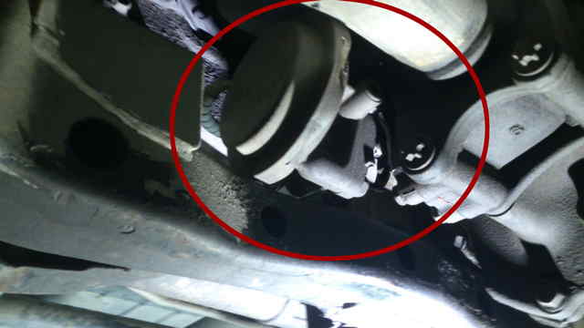

please help! what's this call?
vincent Lu
does anyone knows what this part's call?
it's beside the front Diff to control the 4x4.
i need to know it's name that i can order form parts diller.
thanks!

Even if that WAS on his Tcase (which it isn't), you are incorrect. He has a 3rd Gen with the vacuum acutated diff, which means its 96-2000. The Tcase shift motors come off without taking the Tcase apart. Later model 4Runners DO require the removal and disassembly of the Tcase so you were somewhat on the right track.
We call it an ADD Actuator at our shop. Why order that from the dealer, those should be readily available used?!
Toyota officially calls it a "ACTUATOR ASSY, DIFFERENTIAL VACUUM" Part number 41400‑35020 and fits 96-2000 4Runner W/ADD and 95.5-2000 Tacoma W/ADD

by the way, now i know what it names call ,and i'd took it off by my self already, it's easy to take it off!
