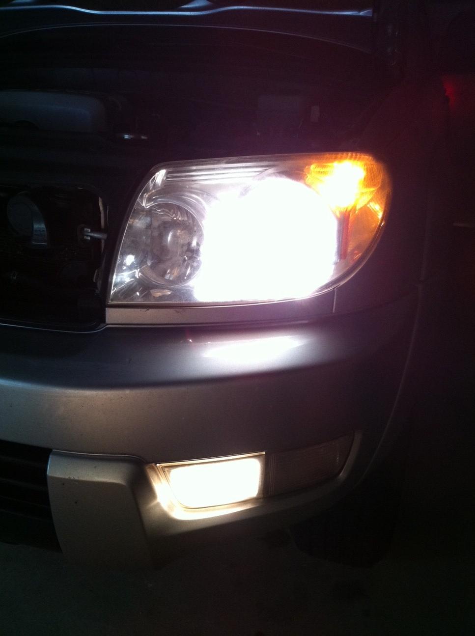

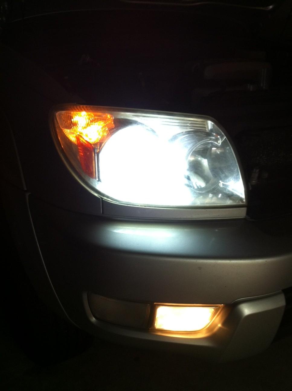

I have the DDM 5k 35w kit in my '05 with reflectors and love them. I've had them for about 2 months and have not been flashed once by oncoming traffic. That being said, I've adjusted my headlights down a bit to compensate for my lift (about 2.5" in front). I think a lot of people forget to do that. My buddy who has a lifted Taco only runs Sylvania Silverstars and hasn't adjusted his headlights down and they are BLINDING. I keep telling him to adjust his friggin lights and he keeps fogetting.
That being said, I'm still getting projectors, either '06 housing or retrofit in the near future. 1) it does cut down on any glare from a reflector and 2) it just looks better. I'm just waiting on my tax return to get them. If you do decide to get HID's with your current setup, don't get 55w as they will blind other drivers. They are really bright.
1st pic is of standard Silverstar Ultra's...2nd pic is DDM HID 5k 35w kit

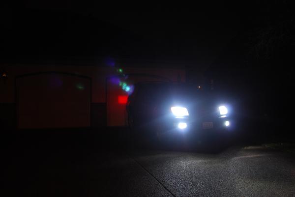

H.I.D's are must, heres a pic from a few years back when i had 8k lows and 6k fogs. Now im running 8k/8k
Are you f**king for real? I am blinded just by your picture. No one with any common sense would recommend HIDs in a reflector. The illusion of more light is just that, an illusion. Instead you get scattered light in all directions...works great if you are looking to see the birds and squirrles up up in the trees. Every time I see someone with your setup I get the urge to follow them untill they park their car, and then put a wrench through those lights. I strongly encourage you to do the right thing and stop trying to kill people with blinding lights on the road! :gun4:
