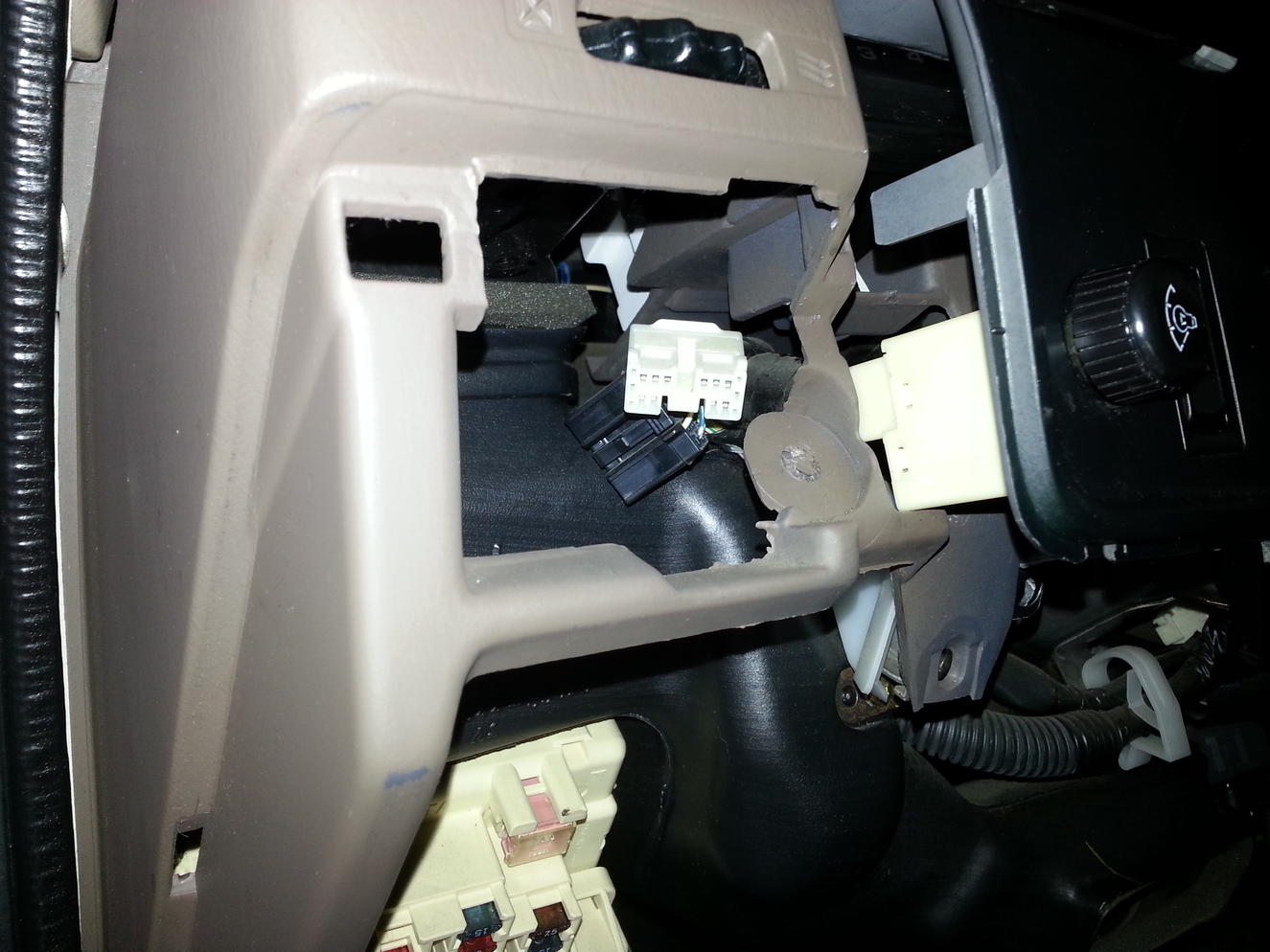

Just wanted to see if anyone knew what these were. Theyre behind the dash not plugged into anything right where the dimmer and e-locker wires are. Also, i have an sr5 and do not have the factory fog lights, just the little plates that cover where they go. But under the bumper, there are wires just sitting there so the wires are already ran.

Yeah, definitely not fog lamp switch. The lamp sockets are out front and wired to an empty relay socket under the hood. From that pic I'd guess the white plug was for the Remote Side Mirror Control (10 pin plug with 7 wires) and the black was "Back Window Lock Switch" (10 pin plug with 2 wires.) Everyone of these will have unused plugs here and there for features that may not have been used or slight year-to-year changes. A picture or description of the plug and wire colors would be helpful if you really must know what they are.

The black box is for the "toyota security" blinking light, and the white box is for the dash lights dimmer switch. Just had mine apart putting in some LED's. Looks exactly like my connectors on a 2000 4runner SR5.
if you look closely in his first post, his dash lights dimmer switch is connected already so that not it.....

Yeah the dimmer switch is already connected so I don't think that's it. Also not sure I feel comfortable enough opening up the steering column and replacing the stalk. I was thinking about just buying a factory fog switch and going that route.

Also, those plugs go to various options that your 4Runner either doesn't have (ie Clutch start cancel), or wasn't available in the US. Toyota created generic harnesses rather than individual harnesses for every single different market (ie Canada). Other parts of the world got cool options we never did :(
