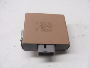

I would say antenna relay plug. See this image of the relay:
Should be obvious if your power antenna doesnt work.
That could be it. The A23 antenna relay plug is grey and 3 over five pins, but the top did not look exactly right. The drawing shows the top as flat where there are those very shallow slots in the photo. Definitely worth a look. Those drawings can be off.
Well, here's my issue.
I got rid of the stock power antenna, and am using my CB as my radio antenna. Been gone for years.
I'm leaning toward the antenna relay. Everything works as it should, so I'm just going to leave it off until something doesn't work. Then I'll know. [emoji23]
