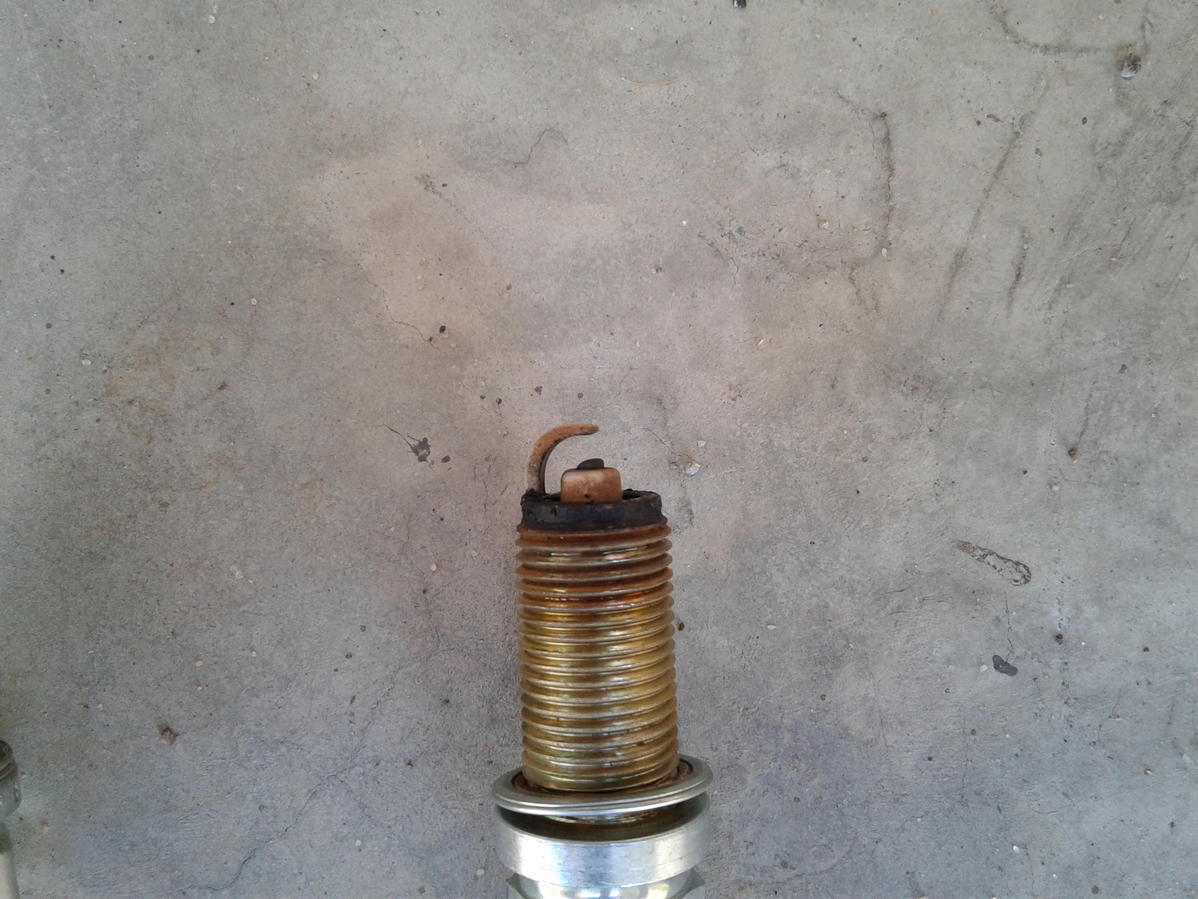

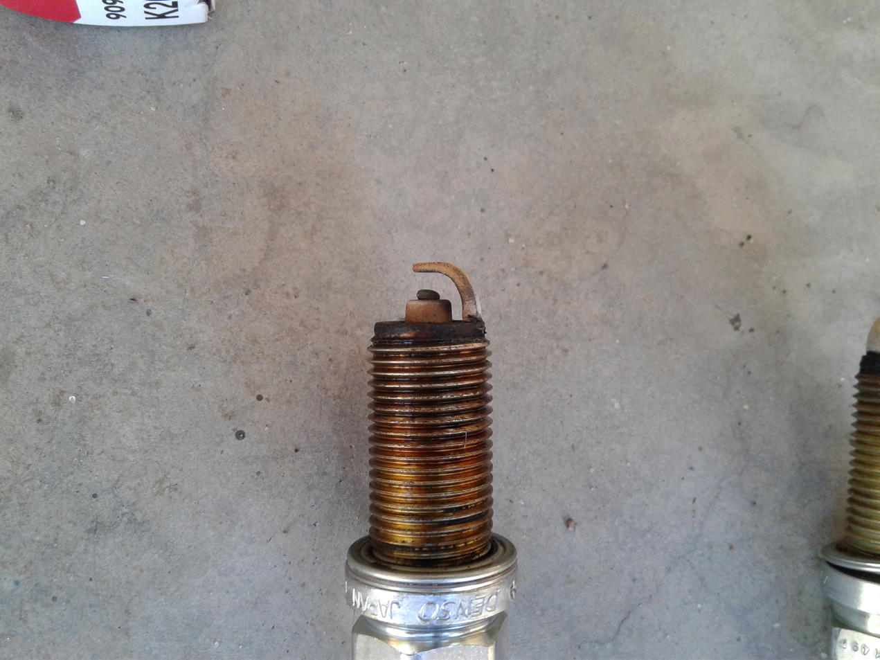

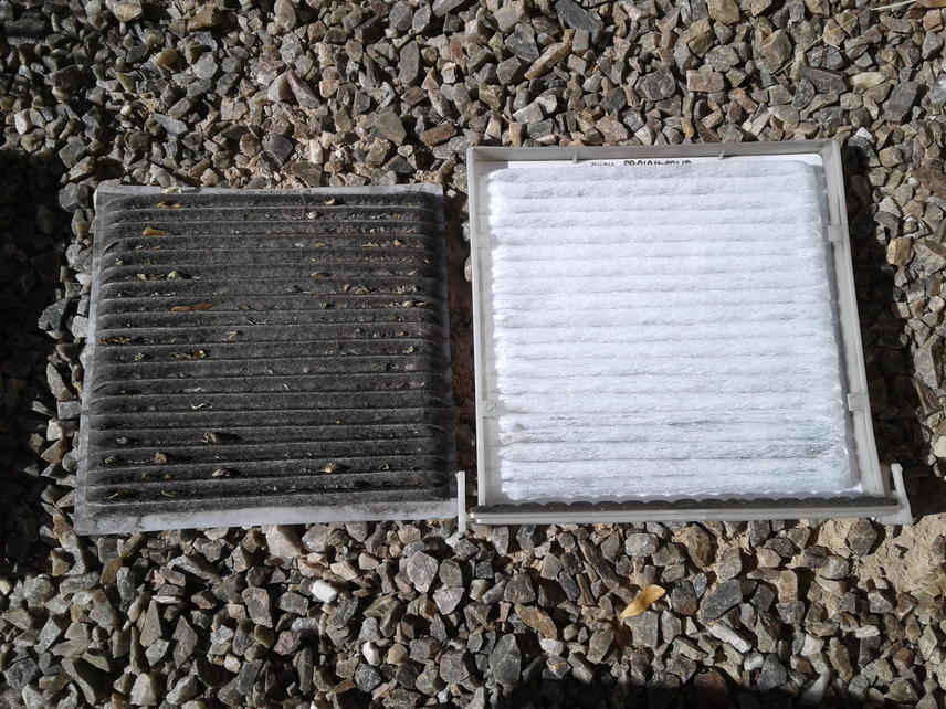

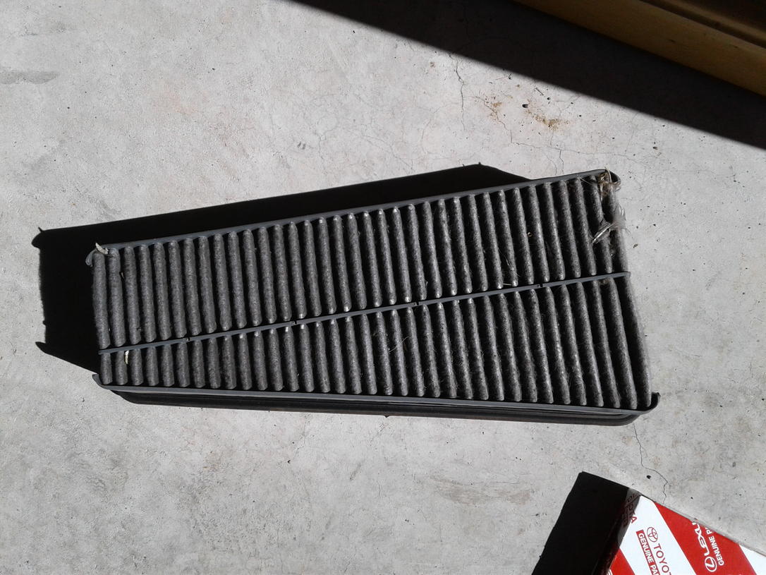

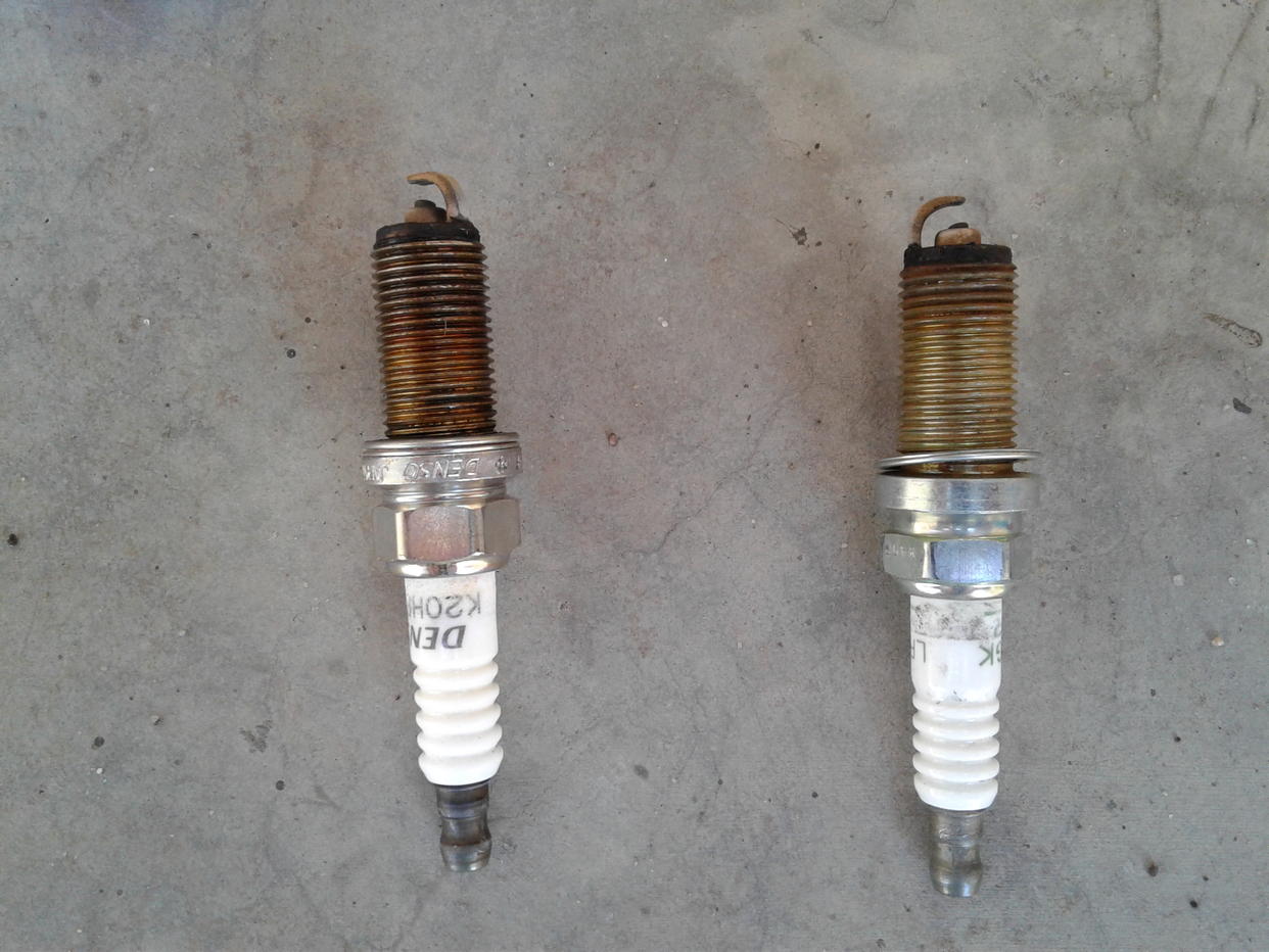

I'd say these should have been replaced about 150K miles ago. Just bought an '05 V6 with 195K miles. These don't look very good. The gap is measuring at .080, about double what it should be. Notice the two different brands of plugs? I've read here that is indicative of how they came from the factory. Engine and cabin air filters were in 'great' shape too. :wow2:

It's the V6 spec'd out for good ol copper plugs rated for 30k if you go by the book.
Lots of "new" owners finding this nugget out .. but its a testament to Toyota and the motor. Still runs with no misfire codes for plugs way out of spec.

I was commenting on how worn out the electrode is on his plugs for not being replaced at the recommended 30k mileage.
OEM plugs have always been NGK and Denso. Toyota gave one side of the block 1 brand, the other side the other brand. It's a great mystery. But either brand works. Just find the right size.
V6s got coppers. V8's got laser iridium's.
