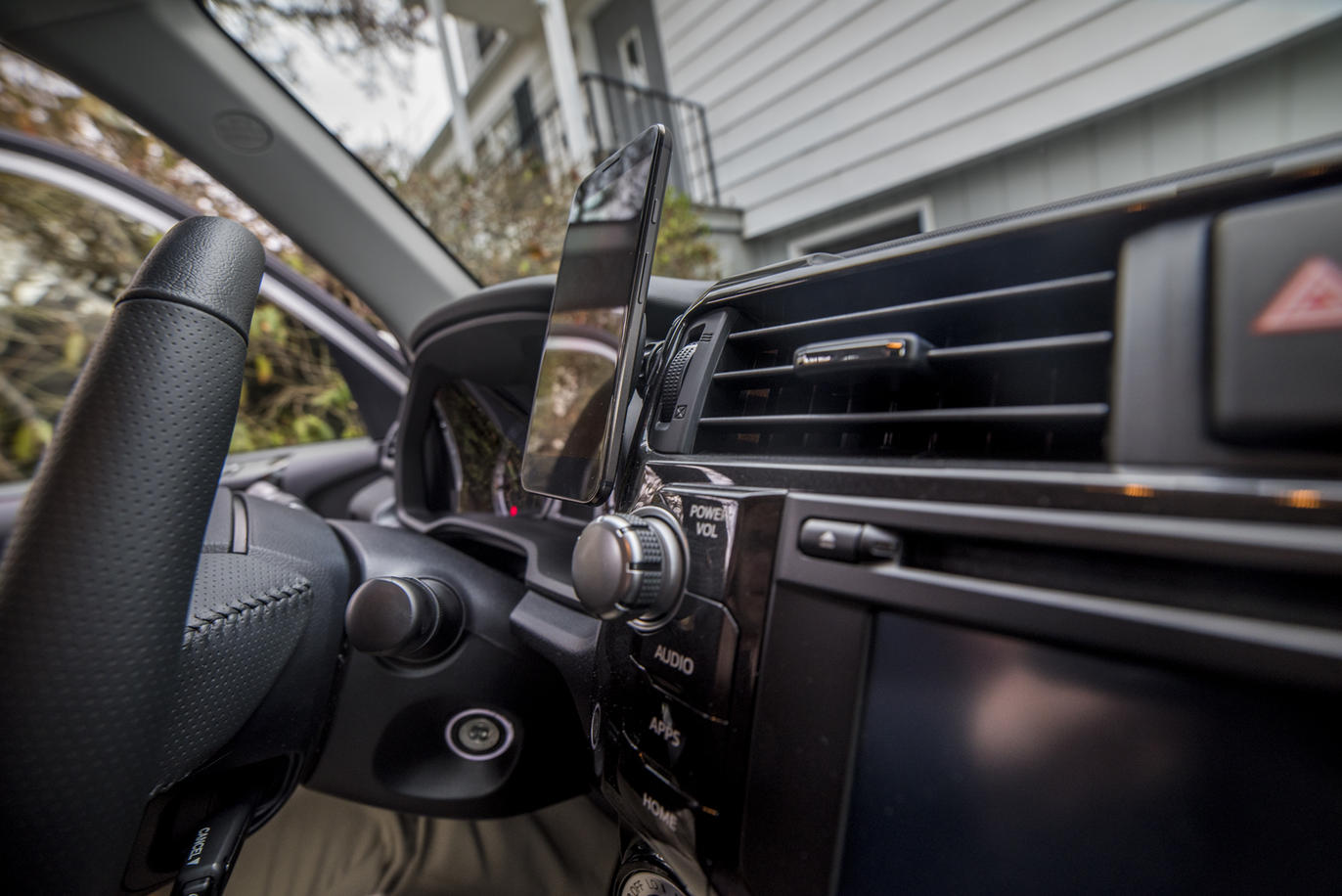

Again, had one of these in the previous rig, and 100% needed one in this one. Basically this thing sticks on with pre-applied 3M tape, and then it's just a big ol' magnet that attaches to a little plate that you stick on the back of your phone.
It was much easier to find a spot on the 4th gen, but I saw a number of people drilling in to their dash in this spot for a RAM Mount, so I went for it. I wanted something that wasn't so permanent, so I decided to try it out. Never had a problem with my phone falling or anything while offroading on the previous rig, so I am confident this will hold up pretty well.
As you can see, it is a pretty awesome fit. The phone doesn't contact the dash at all, and it is pretty visible for navigation, etc from my usual driving position. All in all, super happy with it and how easy it is to plop my phone in and out.

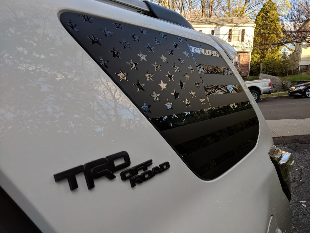

Blacked out the silver emblems and am loving the look overall. The black and white panda theme is a real winner in my mind lol. Easy enough to install. Basically just a cover with 3M tape on the back. Press on and booyah you got yourself some black emblems.
Also did a set of flag decals for the rear windows from OverlookGraphics. Really tricky to install to be honest. I thought these came pre-cut, but they didn't. Having to apply and then cut it was much trickier than I thought. And peeling such a massive decal across the window proved to be difficult single-handedly the first time and I got a bit of a rip in the decal. Unfortunate, but they will get scratched up eventually, so no harm done really. Super happy with how they came out and how they look on the 4Runner.

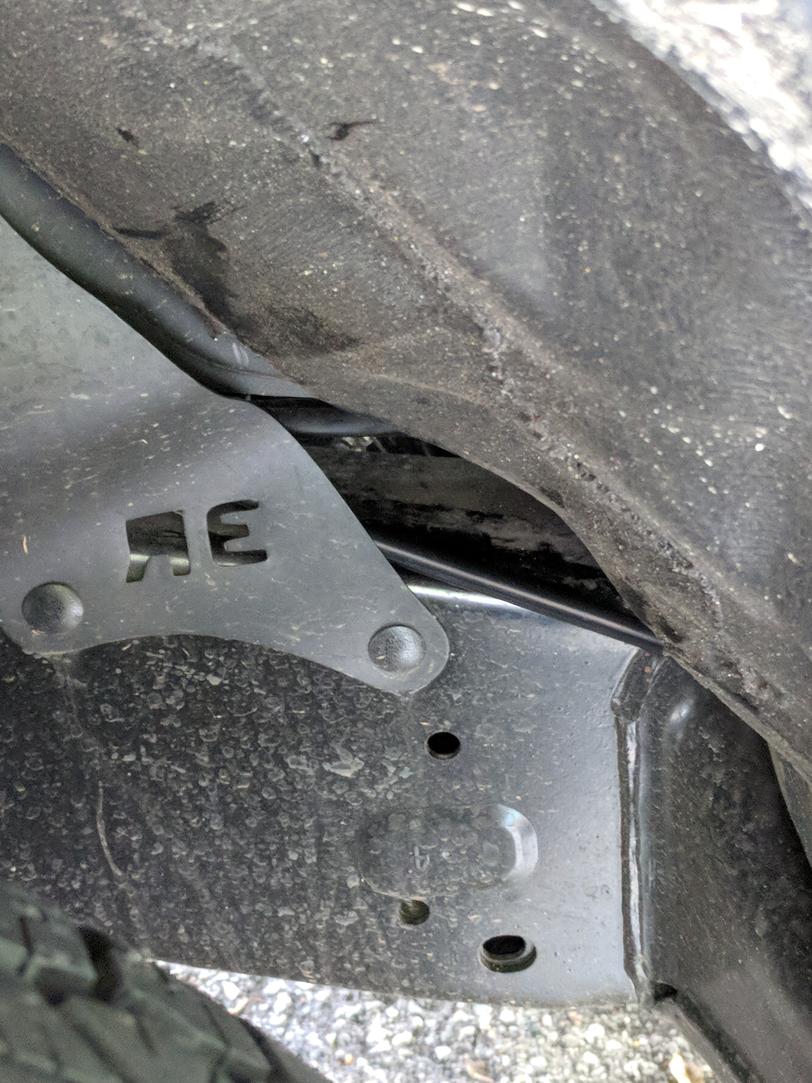

Wanted to make sure I get my rear diff breather up and out of the way just for some peace of mind. The ARB Diff Breather kit makes it pretty damn easy which is great. Ran the hose from the rear diff with a flex loop up by the gas tank, along the top of the frame rail, and then through the engine compartment.
The original plan was to mount the breather just to the left of the master cylinder (when facing the front grille) but I couldn't get the self-tapping screws to bite very well, and I was being a bit of a ***** when it came to drilling a hole in a brand new truck lmao.
So I ended up just using some zipties and mounted it to the wire harness that is there from the factory. It ended up working really well which was great. I ended up only running the rear diff breather for now, but I am going to go back and run the rear locker breather eventually. Not sure if I will have enough tubing for it from the ARB kit either, so I may just buy some extra tubing to be safe.
I tightened in the fitting pretty well on the rear diff, but it still had some threads showing. I have seen other people with similar threads showing, but just curious if other people know if that is right or wrong. I am pretty sure it is meant to be torqued to 30 in/lbs but I just did about as tight as the factory breather.
