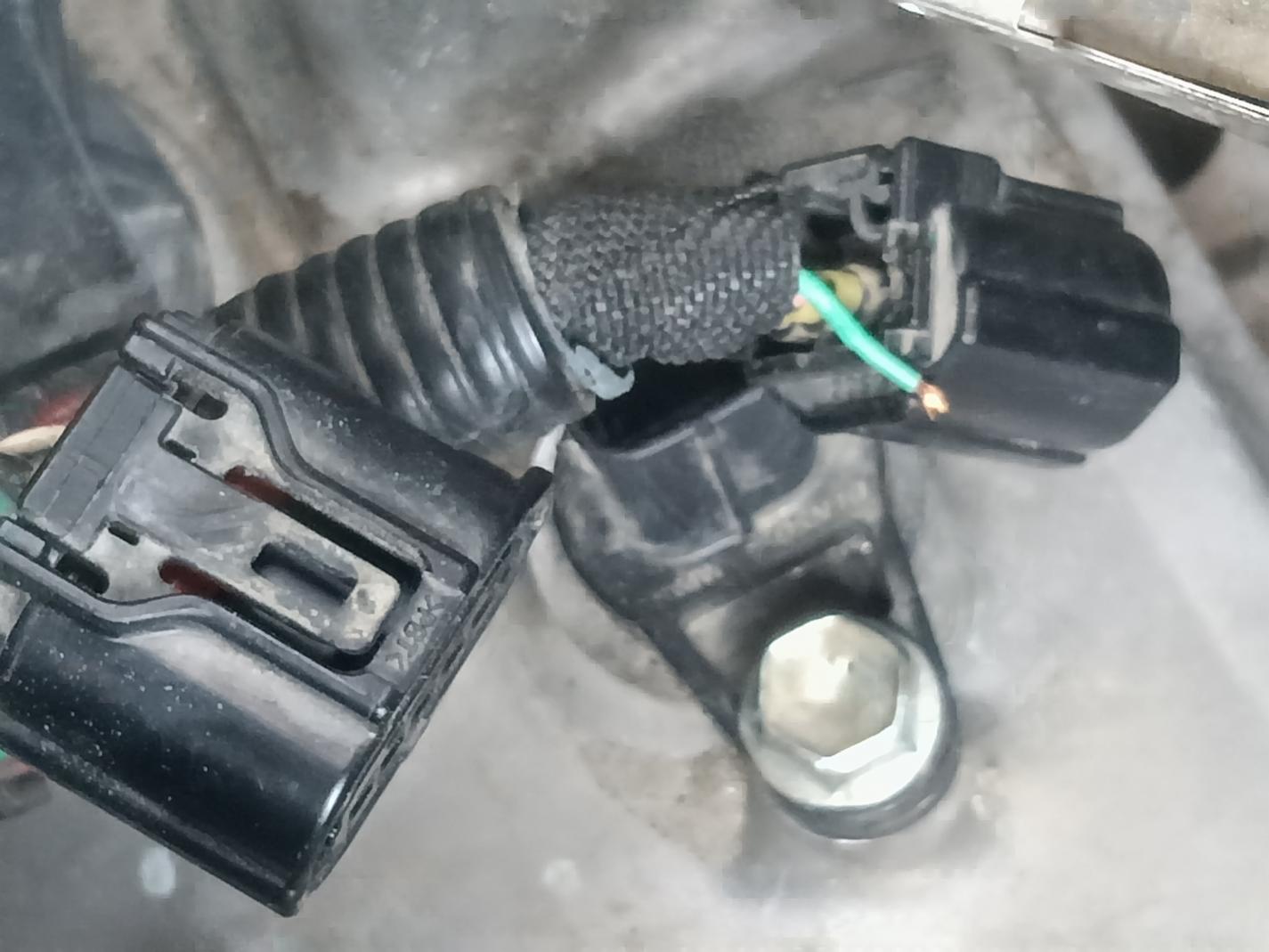

I have a 2015 SR5 with a P0390 code. Can someone please show me with easy to follow pictures where the Camshaft Position Sensor 'B' Circuit Bank 2 is located?
I had to reply to this guy's trdsport253 posts from 2023 because it's the first thread that pops up when you search camshaft position sensor b bank 2 Toyota 4Runner. Hopefully this helps others. After my own research and changing the sensor turns out that this solid green wire on the sensor plug becomes loose when changing the spark plugs. I was able to push it back in and use some gorilla glue in the back housing and all is good. This sensor is located on the driver side right side between the cylinder closest to the radiator and in between the middle one.
