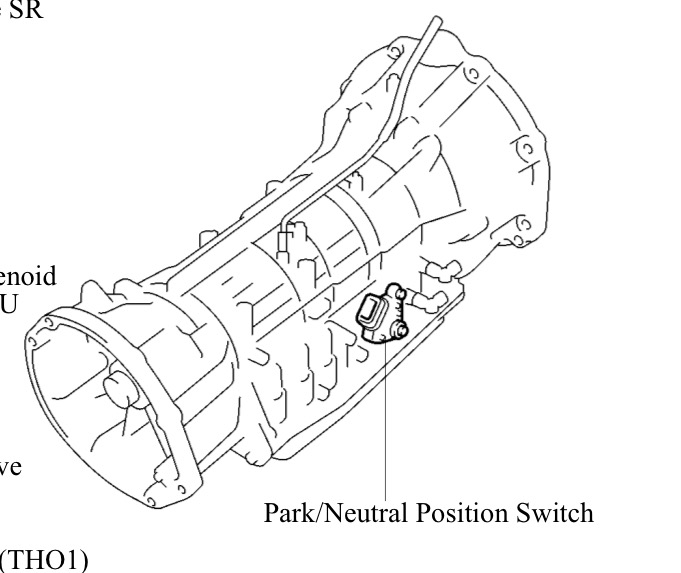

Hmm, got a PO705 code today. Transmission Range Sensor error. From what I've read it's basically what I know of as a Neutral Safety Switch. I was working in adding a WDH on my trailer and it appears there may be a connection to that. Maybe the trailer wiring, maybe not. I don't know.
Can anyone tell me where the sensor is located and anything that might help get rid of the codes for good? Yes, I can get rid of it with my scan gauge but I'm not looking for a quick fix, I want to fix it.
TIA!
