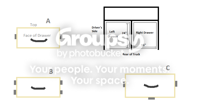

Greetings All,
Need some advice on which route to go with drawer slides for cargo/sleep platform I'm building. Couldn't find anything heavier duty than the 24" 100lbs/pair slides at my local box store. This project is full swing, and I'm not putting it on pause to order super heavy duty slides. My thought was just to increase the amount of slides on the box, thus spreading out the load and giving it a higher lb rating. In my head that makes sense, but I may have talked myself into this theory.
The box will have two symmetrical drawers, a left and a right, and I'd like some opinions on which way to run the drawer slides. Each box will be built from 0.71" birch/blondewood. Each drawer will be 24" deep, roughly 9" tall, and appx. 16" wide.
If the drawer slides are rated at 100lbs per pair, how would you go about orienting them to do a good job? I would like the ability to pull one or both drawers out to act as a table for food prep/projects while out in the woods. So they need to be able to support a decent amount of weight, but by no means will I EVER need the drawers to support a human for instance, as if I were sitting on them.
Hope my amateur sketch can get what I'm trying to accomplish across!
Not sure how the slides compound... but I do know that their weight rating is significantly less when horizontal. So I would rule out option C instantly. I don't think the horizontal slide on the bottom will take ANY weight, as far as adding to the existing 100# for the vertical slides.
I would go with option A or B. Option C would not add that much weight capacity and also not the easiest to implement. B will add more weight capacity over A. If you are planning on keeping tools/recovery gear then go with B as those pounds will add up quickly. Also, my philosophy is to over build as you never know what the future may hold.
Didn't know this, thank you for enlightening me.
I like the idea of B because I'm just as overkill as Tim the Toolman Taylor, (I bet Binford makes a "Drawer Slide 5000" that could do the job), but by buying 8 smaller slides, I'm close to the territory of spending money on 4 heavier duty slides, and waiting.
I used option A and have not had any problems. I also used 100lb 24" slides. I've never cooked on top of my drawers (that sounds messy), but I will set my tool box down on top of one when it's opened. I'm not sure of the exact weight, but I know it's a lot more than my stove...
I also try to keep my heaver stuff near the back of the drawer so that when it's all the way open it's not putting so much stress on the slides.
tl;dr: I think option B will be overkill unless you're planning on resting your full cooler on top of the fully extended drawer while you're cooking.

Thanks Alex! this was exactly what I needed to see. If the 100lb slides worked for you, then I'll probably just go with simple option A. I'll be carrying with me basically everything you show here, with a few minor differences.
