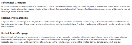

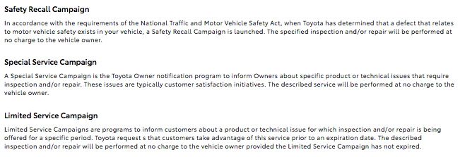

What site did you go to when checking this info? I called a dealer once but this looks easier!
Btw, does anyone know if dealerships will still honor this recall if their records show it hasn’t been done?
I created an account here:
and entered my VIN. There's a Service History tab that shows any work done by Toyota. The record for this just said RECALL until I clicked on "show details"
I don't think there should be a time limit on recalls if they don't have any record of doing the work, but I don't know for sure..
Just found this:
